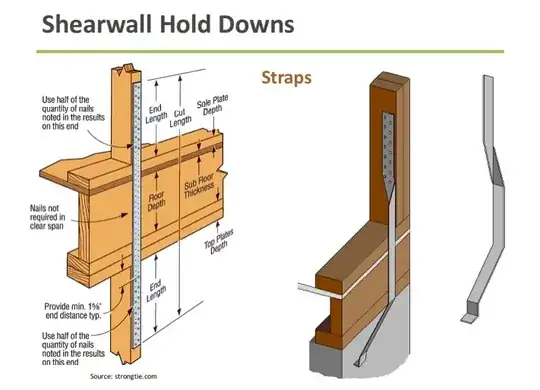

The wall studs and sill plate should be fastened to the 2x12 joist using tie-down straps. The first picture shows the details (from woodworks.org; the second is the available strap from Simpson Strong-Tie. However, you need to consult with a structural engineer to determine the magnitude of forces the tie and the connection are to experience during an earthquake event.

  • I agree 100%. The twist strap drawing, however, isn't clear to me. Does that indicate that the bottom part of the strap, below the sill plate, is to be _anchored to_ the concrete foundation, or should it be _embedded in_ the foundation? I know this isn't your drawing, but I'm hoping you, or someone, might have insight... – FreeMan Oct 19 '21 at 15:59
  • @FreeMan It is unclear to me too. But, since it is a tie-down for uplift, so I think it can be done either way, especially for retrofit works. For OP's case, I think it has to be fastened to the 2x12 joist to make the wall and the floor a whole unit. If it is possible, I prefer to at least double up the 2x12, so on top of the strap, the sill plate can be adequately nailed to the joist to gain shear strength. – r13 Oct 19 '21 at 20:30

  • @FreeMan and r13 the one on the top right is intended to be embedded in the foundation as an alternative to J bolts. The top left one and bottom one are intended as after-construction add-ons. – TylerH Oct 20 '21 at 19:40
  • @KJ7LNW Wood is flexible (and foam is even more so). You shouldn't have much of a problem cranking down sheathing around these thin straps (they are really quite thin, like 1/8 inch thick or less, usually). Use a few screws if necessary to pull the sheathing in tight if necessary. – TylerH Oct 20 '21 at 19:41
