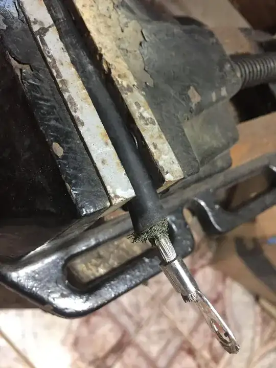

So I decided to be the guinea pig and just see how it goes. I fixed the end portion of the wire on my vice, not very tight so I wouldn't damage it, leaving just a tiny piece of it out.
Wire on vice
Then I used the angle grinder with a thin cutting disc and approached the wire close to the vice, not using any force at all, just approaching it slowly and it cut through it pretty nicely. There was a couple strands that were left out which I finished cutting with the small pliers I had here. Never mind the color at the end of the strands, I cut too close to where tin/lead solder was applied, so the very tip of the strands still have it.
Final cut
Then after removing the isolation so I can crimp the new terminal:
Finished
So verdict: Yeah, if you don't have the pliers it's possible to make a clean cut on the cable with an angle grinder, not that I'm recommending it :D
