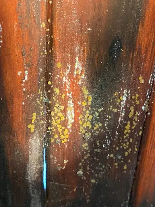

Lower end of the inside walls of a redwood cabana - the black discoloration/mold has been there (where the wood gets wet from drips/spray from rain). We had rains a week ago and went to clean the area and found these yellow things. We do have many spiders all around the year. Spider eggs? Yellow mold? something else?

I think that's not sap but fungus. Because:
Those boards look old, and the black color looks like there's already fungus under the finish. If so, and if the yellow globs actually are new, "coming out after a rain, that's absolutely NOT sap. Sap comes out slowly over a couple years, and won't come out in rain.
If the globs are firm, are sticky/gooey and smell like sap, and aren't really new (you just never noticed them before) it's sap.
But if the globs are "squishy" like you say, or "watery", and really just popped out after a rain, they're not sap but fungus.

They are fungal fruiting bodies.
https://www.ediblewildfood.com/blog/2012/10/witchs-butter-edible-fungi/
To my eye it looks like golden jelly fungus or "witch's butter". Your board is rotting. But the good thing is that if it is witch's butter it is edible! Come back and let us know how that goes.
