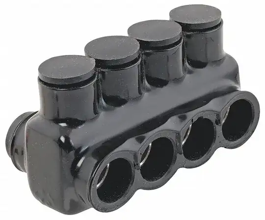

The plan from here was to use Polaris connectors to splice each of the feeders and the ground so they both carry on to the cabin and also to the garage. enter image description hereThe 250 kcmil will then attach directly to the lugs of the 200 amp garage sub panel.
What does everyone here think of this set up? Even if it isn't your ideal design, does anyone see anything wrong with splicing the feeders in a weatherproof box, after the meter/main, to serve the two separate sub panels? Keep in mind, most of my utilities will run off gas, so no dryers or ranges.

I think you have shown the IPLD Series, which are dry location only. If below grade (and even recommended if in a NEMA 3R box) you need a IPLWB or other wet location connector.
