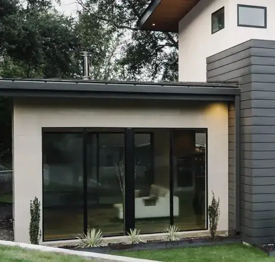

Finally, posting photos of the exterior, as well as the photos of the look we are going for.
Thanks so much!
The look I am going for
