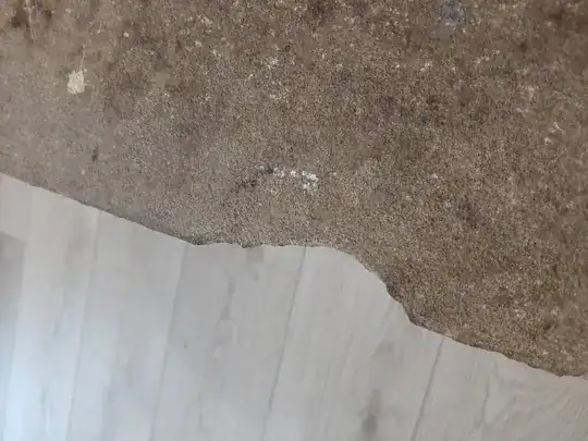

I am working on an old fireplace and there seems to be some damage to the hearth.
The middle section has some damage on the face and I'm wondering how to go about repairing it. They are made from concrete it appears and have a distressed face edge.
Here is what it looks like from the top.
broken hearth from top
Here is an image from the front. front view
And here is how it is supposed to look. undamaged hearth
Is this fixable? If so, can anyone give me some direction on how to go about fixing it.
I would prefer to patch it and match the existing pieces as best as possible without covering it or adding any sort of nosing.

Since you have the pieces, that's where I'd start. Use wood glue, project adhesive, or epoxy to reinstall them. Take care to not leave any exposed adhesive, as it won't easily be removed. Use masking tape to secure the parts while the glue dries.
Then, use some concrete repair material with a sandy texture to very precisely fill any gaps to smooth things out.
This will get you closest to a decent patch. You'll retain the proper color and texture over most of it. Any other approach will just draw the eye to the repair.
