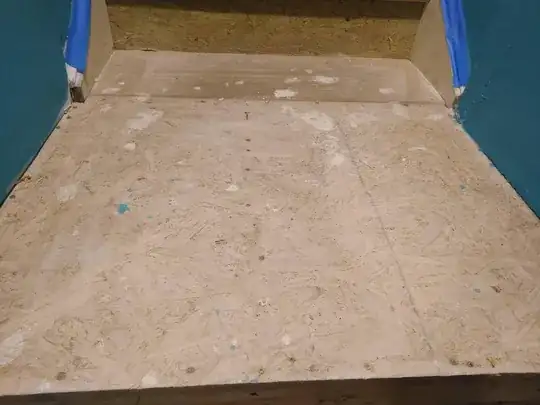

I am currently wrapping up finishing my basement, and am trying to figure out what to do with my stair landing. Because of a ~2" increase in height compared to my old basement floor, I had to install a 36" long landing to compensate. Currently the landing just has the unfinished OSB, but I want to finish it off with hardwood or something (the basement floor is a hickory floating engineered hardwood).
My question is, how can I finish this 36" landing to cover up the ugly OSB? I see I can purchase stair noses which is fine, but for landing treads I don't see anything that can cover my 36". I'm assuming my floating floor would not work on this landing?
Thanks in advanced
EDIT: Added pictures for clarity
Top View
Bottom View

  • A couple pictures will help us visualize what you are working with – Kris Nov 11 '21 at 03:36
  • Sure thing, added to the main post. Thanks for looking! – J. B. Nov 11 '21 at 03:51
  • The floating floor should work if it is well supported(like a floor) and has a stop at the end to keep it from sliding off. The last step and OSB does not seem to be flat and level enough, looks like a ridge there. – crip659 Nov 11 '21 at 18:57
  • There is a bit of a ridge there, I'll check when I can how flat it is. If its not flat enough, are there any other suggestions for how to cover this up? Even if its not a 100% color match to my floor that would be fine. – J. B. Nov 11 '21 at 19:12
