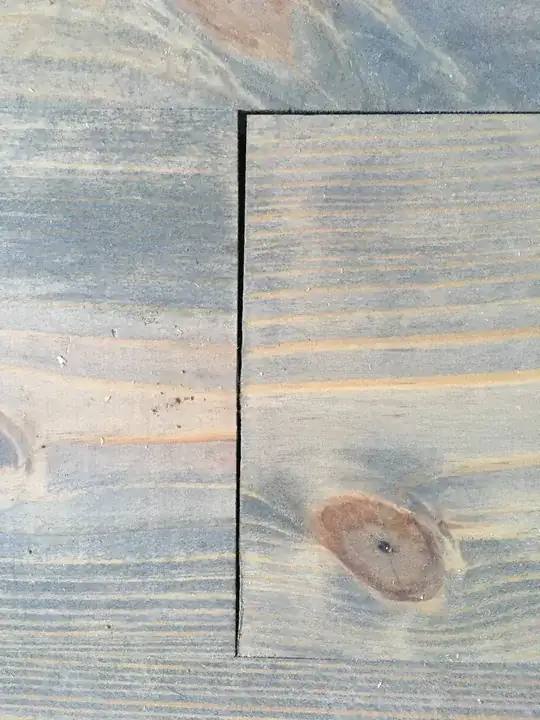

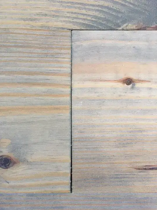

We are building a home. We selected a solid pine floor which comes prefinished. It has tongue-and-groove on the sides, but not the ends. The builder & installer did NOT cut the ends of the boards to ensure tight square butt joints, so we have a large number of but joints with out-of-square gaps. See photos.
The builder and installer said that the supplier (a third generation outfit in GA) told them they shouldn't cut the ends in order to preserve the finished ends of the boards. When I spoke with the supplier he said "I told them no such thing! They should have cut them and then used the can of finish that came with the wood to finish the cut edge." That is what makes sense to me. The builder's story doesn't make a lick of sense except that they were trying to get the work done fast and cheap.

  • Did you ask for a "rustic barn floor look"? Unless you specifically asked for a turn of the century inspired floor, that looks unacceptable. What is the last image? A transition or threshold? – JPhi1618 Nov 11 '21 at 19:02
  • It does seem like it should been done better, since I imagine they the tools to do a good job. My opinion only since they might have trying for rustic look. – crip659 Nov 11 '21 at 19:03
  • @JPhi1618, to answer your first question, we definitely did not request a rustic barn floor look. And yes the last image is a transition from living room to tiled kitchen. – 208_man Nov 11 '21 at 19:18

    This is mainly a problem between the builder/installer and yourself. Would send the suppler these and more pictures of the floor and see what they say, but butt joints should be an easy cut to make and look right. This might be question for the law se sister site. – crip659 Nov 11 '21 at 20:46
  • Although I will say that the selection of pine for a floor all but indicates the desire for a rustic (and therefore roughly-built) floor. Pine is soft and knotty and gets beat up quickly and is really only ever selected specifically for an old, hand-milled look. With that in mind, "yes" is also a perfectly valid opinion, and most of the bashing of the builder/carpenter here is unwarranted. – isherwood Nov 11 '21 at 23:53
  • @isherwood historically that could be the reputation among some but there are lots of classy applications. This house's upgraded finishes are anything but rustic (costly balustrade, upgraded tile and tile backsplashes, custom walnut cabinets, quartz everywhere and high end plumbing fixtures.) This particular pine cost more than some oak options considered. – 208_man Nov 11 '21 at 23:57
What you show is not acceptable. Without seeing the overall floor I couldn't say whether the whole job is unacceptable or just those few spots. It looks to me like his miter saw is off by a degree or a half. Some of the gaps along the long edge could be from the floor boards not being a uniform width but if that's the case you generally use those where it's not noticeable.

  • Op stated that no cuts were made. The contractor should have squared each end with a mitre saw – Kris Nov 11 '21 at 22:06
  • @platinum-goose, I have shown photos of some of the worst joints. There are plenty of joints that are square and fairly 'tight'. I'd guess that about 60% are good, 25% are just ok, 10% are not good, and 5% are awful. I've shown a mix of the not good and the awful. – 208_man Nov 11 '21 at 22:54
I've never seen flooring like this installed without mitering the edges. Filling in those gaps with a wood filler and refinishing would look terrible. Tongue and grove is done for a tight fit and ensures a tight butt joint but the ends have to be cut. This is definitely unacceptable and you should be getting back with the installer,
