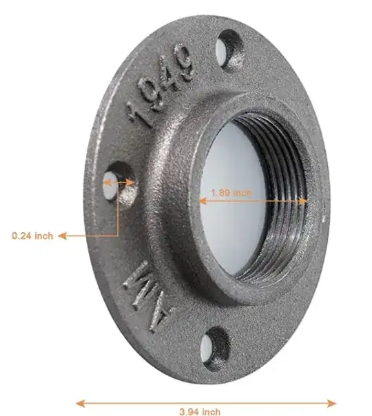

This pipe flange seems perfect but I can't figure out what bearing to use with it. Seems like hanging it by the threads and using those for rotation is not a good plan:

Floor flanges like you show top and bottom would actually work beautifully. Use a little lithium grease to keep things from seizing up and be happy with a robust, cheap solution. You could put a pair of cross tees on the mast with protruding nipples for mounting. 1" or 1¼" pipe would look good and could contain power and HDMI cables.
To create a swivel stop you could notch the end of the pipe and put a set screw through the flange.
I would not rely on a single bearing suspension point (as in other answers) outdoors. Even with a high quality bearing you're likely to get movement in any substantial breeze, and if your balance isn't done just right it's likely to lean.

  • This sounds promising but over my head. Earnestly searched `cross tees protruding nipples` with unexpected results. (ツ) Basically you're saying to use the pipe flange and let the threads hold the weight and perform the rotation (with a limit). Could you explain more on the single bearing point and cross tees? Like I should use a 36" pipe with the flanges 18" deep in the cabinet/wall. Then use clamps above and below the center so it wont sway? https://www.amazon.com/EVIL-ENERGY-Exhaust-Preformed-Stainless/dp/B07YDHN42Q – bendytree Nov 16 '21 at 15:21
    You're overthinking it. I suggest a few minutes standing in the black iron pipe aisle with your thinking cap on. It's just like when you were a kid playing with Tinkertoys. See my updated answer for some clarity. – isherwood Nov 16 '21 at 15:52
    I like this answer. It's simpler than either of my answers, and it's the only one where you can rig up the entire solution using off-the-shelf parts in a hardware superstore, so you know exactly how it's going to hang together. – jay613 Nov 16 '21 at 16:04
