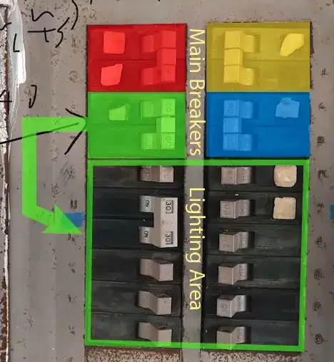

We've inherited an old house, and the original panel for the house seems to be a subpanel to the new service panel that primarily has electric baseboard heating, and two 20A circuits of receptacles in the kitchen. In trying to figure out how things are wired up, I found this panel on the back porch behind the kitchen.
The indicated 5-7 double 60A breaker interrupts the lights in several rooms downstairs in the house.
The fading words do not match completely match the switches, but it lists "5 Range", but there is no electric range in the house. The kitchen has a gas range plugged into one of the new panel's 120V 20A circuits.
Is this breaker reasonable for the lights? Or did someone hack the lights onto a leg or two of the 60A range circuit?
I peeked into this kitchen lights switch box, which is controlled by this 60A breaker, and the wires look like relatively new Romex enter image description here

39
What that thing is.
When the house was built, breakers larger than 60A were prohibitively expensive (a bit like 400A breakers today). Now there is a "Rule of Six" - a facility can't have more than 6 handle throws to completely turn off power. So the answer for >60A services was to have multiple main breakers.
You are looking at a Split Bus panel. The top 8-12 breaker spaces (I suspect 8 on this panel) have their own bus fed straight off the meter. They are intended for up to six "main breakers" that actually power your large 240V appliances (dryer, range, A/C). But they also power one "Special" main breaker: called "Lighting Area" breaker.
Back when these panels were conceived, "Lighting" was the primary use for 120V circuits, hence the name. Anyway, this 60A "Lighting area" breaker powers the second bus in the split-bus panel -- spaces 9-20 I think. 240V circuits are also allowed there.

Split-bus panels are kind of dangerous. By design, they are oversubscribed - the main breakers add up to more than the service size. (yours has 60+50+30+30 amps of "main breaker area" breakers; probably on a 100A or 125A service back then). That was allowed because the Load Calculation at build time estimated the draw would be well within limits. The dangerous bit is upgrades. You're supposed to re-do the Load Calculation, but nobody ever does. So, "Rule of Six" main breakers have been banned.

Anyway, at some point, the homeowner upgraded. They installed a new main panel outside, and made the old split-bus main panel into a subpanel.
There used to be labeling indicating the Main Breaker area, Lighting Area, and Lighting Breaker. Unfortunately, that faded, fell off or was removed when this panel was subpanel'd. Removing the label that marked the 60A breaker "Lighting Area" was a Code violation. All breakers need to be labeled to indicate generally what they power (e.g. "northwest bedroom receptacles" never "Jane's room").

You didn't know what the 60A breaker did, so you turned it off - fair enough. Yes, it turned off your downstairs lighting. But it also turned off every breaker in the "Lighting Area" (spaces 9-20).
One of the eleven branch circuit breakers in this area would also turn off the downstairs lighting.
All of that is working as intended, and is a reasonable and legal configuration. You could even get it approved today in new construction, since the "Rule of Six" panel is being used as a subpanel.

  • Ah -- this panel doesn't have the single separated main panel shut-off breaker like I've seen in the few panels I've seen, it has a set of smaller breakers that must all be shut off to kill the power. – Dave X Nov 16 '21 at 01:56
    @DaveX yes, it’s not like normal panels, due to the design of the panel, the downstairs lights (and everything else in the lower section) can be shut off by either of two breakers in there. It's more like a panel *and a subpanel* in the same enclosure. – Harper - Reinstate Monica Nov 16 '21 at 02:17

  • Thanks, I'll check it out next weekend. I'm a bit concerned that the folks working upstairs didn't notice the power was out, but maybe they weren't using any. I think most of the receptacles and lights (except for the receptacles on the main panel circuits) should be on the 9-20 breakers. What's the right text to label this 60A breaker for this internal sub-panel? "Lighting Area" seems too narrow, since it might include the receptacles and the water heater. I think the 1-3 is 30A for an AC, 2-4, is another 30A AC, and the 6-8 50A is the Dryer. – Dave X Nov 16 '21 at 04:54
    @DaveX "Controls below breakers" is best I can think of. I would myself stick a "Lighting Area" label in the gutter there from 9-20, and mark the breaker itself "Lighting Area [Down Arrow]". Any experienced electrician will know exactly what they're looking at, at that point. I would expect any dryer to be 30A and 50A to be more typical of a range. – Harper - Reinstate Monica Nov 16 '21 at 05:13
