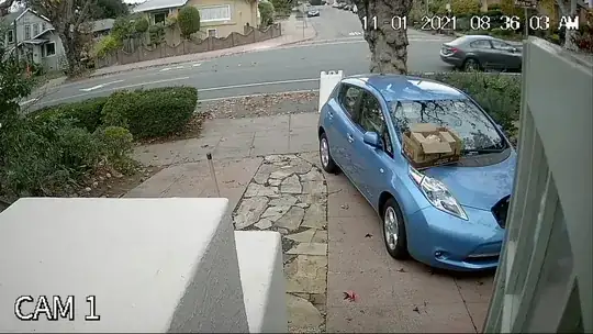

Ok, sometimes my home security camera produces this image: Shadow on Lorex CVI camera image fuzzy Sometimes for hours or days on end it will show: enter image description here
This is a big deal, because I spent considerable time running the Siamese cables to the places needed: if it's a cable issue it's a lot of work to change the cable.
The issue is stable, and not related to motion. Cleaning the lens has no effect, nor does shaking or remaking the connections (other than power as noted below).
The issue occurs across several different brands of cable, power supply, specific camera and encoding format (with some cameras I can switch AHD, HD-CVI, HD-TVI or Pure Analog). The issue comes and goes, and sometimes but not always fixes itself if I power cycle the camera. It sometimes but not always fixes itself if I change video formats on the camera end.
Sometimes I think it's humidity, other times not so sure. Sometimes I can get it to clear up by power cycling, other times it sticks over multiple cycles.
Here's another image: enter image description here
What could be going wrong? This even happens on different length cables (I have not yet correlated if the apparent offset can be changed by adding cable length, as that requires higher voltage to offset voltage loss in the cable). I have not yet tried an attenuator. I assume it's a reflection on the length of the cable, but not positive.
The DVR is from a well known Chinese company that merged with or bought out an American name.
Has anyone seen this? How did you solve it?

According to the information you have provided it appears as though the cameras, cabling, and installation are all in working order. Very helpful that you provided good and bad images and images from multiple cameras!
As noted in the comments above, it seems most likely the problem is within your DVR appliance. The solution is to look at the fault-finding section of the manual and/or call the maker's support team. We can't help here with device-specific problems like this.
Based on my (admittedly very limited) "research" and the comment below from @Bryce, another possible problem is physical cabling problems. The noted video formats are analog. With analog signals, it is possible to have the noted effects (ghosting, doubling) given certain cable problems like bad terminations, kinks, and others. If there are best practices, diagnostics, debugging techniques, that would help homeowners and installers build infrastructure for newer HD security systems, that would be great information here.
Observation 1: This is pure ghosting, no blurring, pixelation or other fuzziness
Observation 2: The ghosting is purely horizontal
Cam1 enter image description here
Cam8 enter image description here
