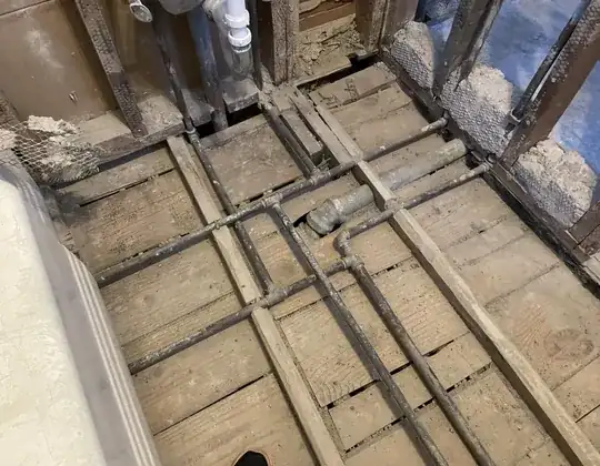

We are currently renovating our bathroom ourselves on the 2nd floor. We were going to redo the tiles only, and we found a newspaper from 1947 around the old pipes which means it was installed a long time ago. We started to wonder if the pipes have to be replaced, but it’s not what we planned at the beginning.
One day we had to call a boiler technician, so we asked him if the bathroom pipe should be reinstalled. He strongly recommend to reinstall the entire bathroom pipes. He assumed the cost might be 10K to replace the entire pipes because it’s the 2nd floor, but he wasn’t a plumber. He told us to get a plumber for an accurate cost. I know it’s a good opportunity to replace them since we already opened the floor and the wall, but 10K is too much money for us.
As a non-professional, I think the pipes are in a good condition. They seem very sturdy and no leaking at all. I think they can stay 50 more years. I’m thinking about closing the floor without replacing the pipes. Please tell me if I’m an idiot.
bathroom floor with exposed plumbing

    These old pipes are usually replaced because they start to fill with corrosion/rust and it affects the water flow. how is the water pressure/flow in this bathroom? – JACK Nov 17 '21 at 22:28
  • Water pressure’s good. I asked to my friend. He said good too. – sol1000 Nov 17 '21 at 22:41
    OTOH, that cast iron drain pipe is gold! It will be much quieter for water draining through it, so you won't hear toilet flushes and showers draining. You'll want to keep that – FreeMan Nov 17 '21 at 23:28
    Reasons to replace pipe/s, leaking, block, or they are lead. Seems like you don't have these reasons. You do have the pipes accessible and would be a good time to do it. This is just a replace job and with PEX a simple DIY job for a few hundred(if that). – crip659 Nov 18 '21 at 00:11
    Not saying whether you should replace the pipes or not but if you're doing a DIY bathroom remodel then you should be able to do a DIY pipe replacement. Most of those pipes will be a standard length and if not a hardware store can cut and thread to the length you need. Time consuming but not difficult. As you install them periodically cap and test for leaks. – Platinum Goose Nov 18 '21 at 01:59
    How much of your joists have been removed to install these pipes? Too much and the joist will be significantly weakened. Britain has regulations about [notching and drilling joists](https://www.youtube.com/watch?v=y7QSTOTMymU) for this reason. Consult your local building regulations office. – James Geddes Nov 18 '21 at 11:36
    @JamesGeddes These pipes seem to be above the sub floor and are using spacers for a finish floor. – crip659 Nov 18 '21 at 11:57
    Man... I had to rotate that image. It was hurting my head! – FreeMan Nov 18 '21 at 13:21
    "We called a professional who makes money off of replacing these, and he said we should replace them" Well, you tell *me* what the motivation is there... :-) – TylerH Nov 18 '21 at 15:15
    You could unscrew one short pipe and examine it. Then you would have all the information you need to make a decision. OTOH, you might cause a problem by futzing with it! – Steve Wellens Nov 18 '21 at 15:29
    @SteveWellens If you try to unscrew a 74-year-old galvanized pipe, there's a decent chance you'll break it. Ask me how I know this. – Mike Baranczak Nov 18 '21 at 16:31
    @MikeBaranczak That's why I added the caveat. But if the pipes ARE that fragile, they probably should be replaced. – Steve Wellens Nov 18 '21 at 23:23
  • If you don't replace the pipes, you should take steps to limit water damage to the adjacent spaces should one of the pipes spring a leak. – Hot Licks Nov 19 '21 at 02:59
    @FreeMan it's also for sure mostly clogged by now... Get a proper PVC pipe and wrap it in acoustic insulation, will also be very quiet. – user11153 Nov 19 '21 at 10:15
  • Yes, it would be a good time to lay down some plastic or spray barrier on top of the wood under the pipes. You can also plan to leave a small trapdoor as an inspection hatch, in which you can stick in a GoPro on a long stick. – JDługosz Nov 19 '21 at 16:18

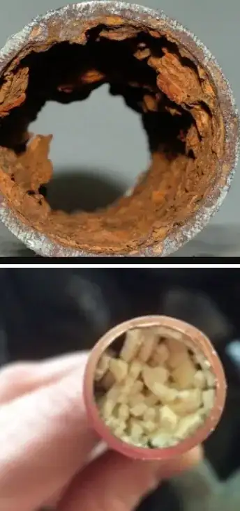

Example images of damaged pipes: rusted and with calcium deposits
Top image is a pipe rusted through, bottom image is a pipe with calcium deposits
The lifespan of old galvanized pipes depends on water balance. If the water is alkaline over 7 pH the pipes will eventually close up with calcium deposits. If it is acid under 7 pH they will rust out and start leaking ( you may see rust at joints.) If the water is balanced this kind of pipe is expected to last 75 years. Hot water pipes generally deteriorate faster than cold pipes. 10k is more than I would expect to pay for this job, DIY would cost a few hundred $ at most for PEX. If there is no rust, and you have good pressure, I would expect to get another 8 to 30 years from these pipes. Weigh this against how long you expect the remodel to last.

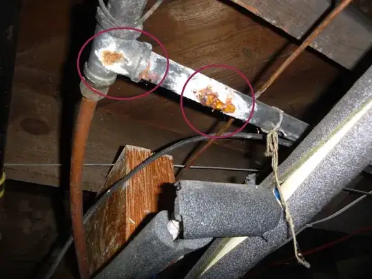

My house was built in 1940 and 2 years ago I replaced all of the the downstairs galvanized water pipes with PEX; costed about $900. Once I'm ready to tear into the second floor you can bet your last dollar that I'll be replacing the galvanized pipes.
When removing the old galvanized pipe I was curious as to how difficult it is to unscrew these joints as opposed to using my sawzall so I grabbed some pipe wrenches and twisted a tee right off; the threads were left inside of the tee.
This particular joint would probably have failed in the next few years. It was rusted down to a pinhole about 1/8" in diameter and was the source of terrible hot water flow for our kitchen and upstairs bath.
Rust begins life on the inside of the pipe and if you start seeing surface rust that that means it has breached the entire wall of the pipe.
Make note of the water leak from the rust spot on the right.
Galvanized water pipe rusted from the inside-out and is leaking
