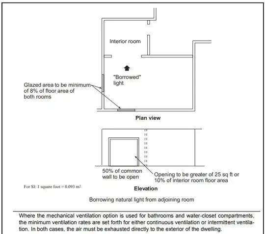

Revised:
2018 IRC R303.1 Code Text: Habitable rooms shall have an aggregate glazing area (total) of not less than 8 percent of the (total) floor area of such rooms. Natural ventilation shall be through windows, skylights, doors, louvers or other approved openings to the outdoor air. The openable area to the outdoors shall be not less than 4 percent of the floor area being ventilated. Exceptions allow the use of artificial light and mechanical ventilation.
A notable warning from a web source:
Remodeler: if you have an existing home and you add a sleeping room, or finish a separate living space in the basement, the code requires that you install an egress window to serve these spaces. Without a means of egress, these rooms can represent a dangerous fire trap if you do not have a quick and easy to operate emergency egress escape window. If you have a basement that has a bedroom, recreation room, den, family room, media room, office, or home gym. All of these rooms are required to have a means of egress.
