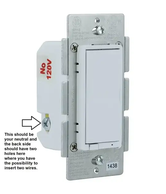

I would try these:
I know this doesn't answer your question but you can't put pictures in comments and it would be hard to describe with words.
