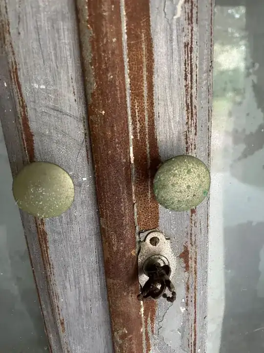

I have a 50s metal medical cabinet that I would like to restore. I don't have access to a stripping tank so what would be the best way to remove old paint and rust. I'd love to get it back to metal and clear coat it.. is that possible?
Picture of cabinet, rusty. 2 knobs with patina

  • That wasn't ever bare metal. That was painted. If it had been metal, it would have rusted *immediately* the night it came off the assembly line. You'll want to remove the hardware and treat it differently. – Harper - Reinstate Monica Nov 21 '21 at 22:16

None of the recommended methods really worked out for me, and in the end I used an angle grinder with a scrubbing disk. I also used an attachment for the angle grinder to attach a vacuum cleaner (this produces a horrible amount of dust). Also it requires sanding after the paint is removed (the scrubbing disk does not leave an even surface).
Eye protection and a respirator are required for this.
I would recommend that you ask a body shop if they can sandblast the thing for you, this will save you a lot of effort and dirt.

  • yes this site is AMAZING - I had read your post but still wasnt sure what to do. I love the idea of sandblasting it.. that is the look I am going for kind of burnished steel.. would I clear coat it afterwards? and if so with what? Its a great case and I have all the original glass shelves. I'd love to post another picture but not sure how... – Julia Mickum Nov 22 '21 at 16:26
  • If this is for indoor use, it will probably not matter all that much. For outdoor use, you need to look for something that is advertised to work with unpainted metal (apparently "standard" clear coat won't do). This page has a few suggestions: https://housetrick.com/best-clear-coat-for-metal/ – Eike Pierstorff Nov 22 '21 at 16:35
    Sandblasting might be a problem for those glass windows adjacent to the metal. I'd recommend removing the glass (windows and shelves) first if possible... – Darrel Hoffman Nov 22 '21 at 17:33
Its hard to tell the size of the cabinet and how much you are going to clean. However, if its a decent size cabinet, you will want to use a gel based paint stripper. The advantage of gel based strippers is that, unlike liquids, they are much more viscous and will not run off like liquid strippers. The same goes for the rust remover. Any hardware store sells them. Neither are perfect and will might require multiple applications. Just follow the directions for the product. Heavy/stuck rust and paint might need steel wool or even sandpaper to remove it. Once its clean, be sure to clean the cabinet thoroughly with a degreaser and alcohol to have a clean surface before you repaint.

You want a bare steel cabinet with clear coat? Sand blast would clean it of paint and rust but leave a grey matte finish; the matte will be nothing like original. With a very large amount of work, you could sand it, preferably with power equipment; but then you would have a sanded finish - unlike original. You could chemically strip paint, leaving rust. Then use conversion coating ( eg. "Navel Jelly ") on rust leaving it mostly a black color; again, nothing like original. Basically you will have nothing like the original unless you paint it.

  • thank you so much as well. this place is great! i want that grey matte finish so sandblasting would be perfect. just need to befriend some auto shop now.. what should i clear coat with ? I am going to try to post another photo – Julia Mickum Nov 22 '21 at 16:27
    @JuliaMickum, while you're befriending the body shop, ask them for a quote to clear coat it. – spuck Nov 22 '21 at 16:32
