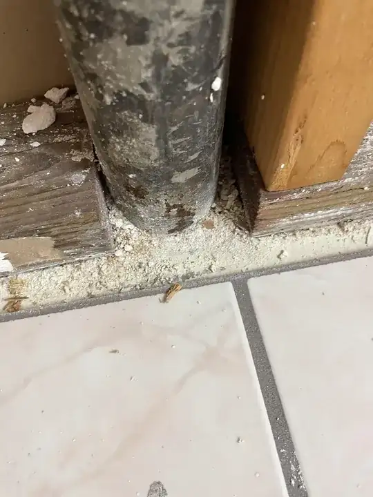

Upon removing the drywall we found this 3” steel pole set in the slab. It sticks out of the slab about 3ft and is lagged to one of the studs. Waterline in the image went to the ice maker in the fridge and the sink is on a separate wall so I don’t believe this is related to anything plumbing.
Is this pipe providing some sort of shear strength to the house, or is it just there to stiffen the partial wall for out of plane loads, since it doesn’t attach to the ceiling?
Photos for reference: View from the kitchen
Pole in question
Set into the slab
Bolted to stud
View from the other side

    Hard to imagine this pipe providing any useful stiffening of anything other than the one stud it's attached to. And maybe not even that since the sill plate is broken to accommodate it. It's not attached to the wall near the ground, the doorway eliminates even whatever tiny effect the pipe might have for most of the wall's width. Maybe it was for stiffening but it was just a terrible idea poorly implemented. – jay613 Nov 22 '21 at 20:46
  • @jay613, that one stud connects to the entire wall via the top plate. That's where the stiffening effect occurs. The break bottom wall plate (not "sill plate") is irrelevant. #latetothegame – isherwood Jun 20 '22 at 21:32

It appears to be a post intended to brace the wall and prevent it from flexing. Likely the wall flexed too much when bumped on that side of the door opening.
A wiser solution would have been to give the section of wall above a more substantial header.
That's exactly what it does... now.
It's the bottom half of a floor support post. They used the holes where the pins go, and put through bolts into a stud that sits on an almost completely cut floor plate which was probably wiggling. And stopped wiggling when they put the bolts in, so they didn't have to go get masonry fasteners to attach the floor plate better.
Why is it there? Probably (temporary) when they cut that opening and/or blew out the roof (and became unnecessary). Or it's an OG artifact and the framer was more OCD than me and took the opportunity to strengthen the wall because there was a 'pipe' right there already with some holes in it.

  • The _one stud_ is connected to the top plate of the wall. The pipe indirectly stabilizes the entire wall via that connection. And there wouldn't have been a need for a steel post there. That home appears to have been built with engineered trusses. – isherwood Jun 20 '22 at 21:30

    A vent line wouldn't be thru-lagged like that though since each of those thru-lags create a leak point. It's clearly *structural* in nature, not part of the plumbing system.. – ThreePhaseEel Jun 18 '22 at 19:50
    It would have been eminently noticable if that was a sewer gas pipe! Well before now. Why would that sort of thing vent into a room? Even if capped, it wouldn't be secured with all those bolts! – Tim Jun 19 '22 at 10:29
