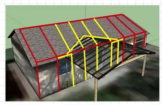

You have to tie the deck roof to the existing building framing. In the picture below, the red lines are the existing joists and studs; the yellow lines are either new additions (joists/studs/lintels in locations that do not have those supporting elements) or strengthening/modification of the existing structures.

The problem I see with what's you've sketched is that load of approximately 1/4 of the added roof is going to be carried by the existing roof rafters, unless you make some structural changes there. This may,or may not be acceptable.
You can avoid this if you use a scissor truss of some sort for the deck roof. With a truss like that, you do not need a ridge beam/board on the deck roof, and the load of the new roof is carried by the beams coming out from the house. Of course, they have to be sized appropriately.
