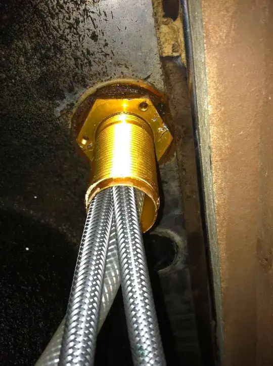

I'm rather intrigued by these washers: enter image description here enter image description here
What are they called?

It's a serrated lock washer. I've seen them used for two purposes:
  1. Locking the nut in cases of vibration.
  2. Ensuring a electrical bond on painted or corroded metal.
Or, of course, a combination of the two. They are mildly effective against vibrations, and properly torqued very effective to ensure an electrical connection.

    They are also useful in situations where you cannot get a tool on one side of a nut and bolt. If you put one of these washers behind the nut, and if you can hand tighten to the point where the lock washer starts gripping, you can usually then fully tighten the bolt without holding the nut. – jay613 Nov 29 '21 at 14:10
    @jay613 I've had a few cases where all I could get on the nut side was long-nose pliers, end on. That's nowhere near enough to torque up the fastener alone, but as you say is enough to get the washer to bite – Chris H Nov 29 '21 at 15:59
  • Pedantically, an "external tooth lock washer". –  Nov 30 '21 at 19:03
They're anti-vibration locking washers, the teeth digging into both the nut and whatever it's holding. They are also available with the teeth on the inside (as the pic), rather than as shown above, the outside.

  • Honest questions: How can you tell that the teeth on these are on the outside? What happens if one just puts the washer on upside down, wouldn't that put the teeth on the inside? How does one know if one needs teeth on the outside vs inside for any given application? – FreeMan Nov 29 '21 at 13:00
    @FreeMan - I meant the teeth can be round the hole in the washer rather than on its circumference. Come on! – Tim Nov 29 '21 at 13:02

They are spring locking washers.
They are designed such that the "teeth" oppose the nut vibrating loose.

    Ah, now there y'see a spring lock washer means something different to me; I think an SLW looks more like someone cut a single coil off a spring and squashed it.. – Caius Jard Nov 30 '21 at 16:50
    A machinist might know what you are talking about if you had a box of these, but if we are being pedantic spring lock washers are conical and have serrations or ribs that help grip (i.e., no teeth around either circumference). What we see above is a toothed lock washer. Other common kinds of spring washers are split lock washers. –  Nov 30 '21 at 19:00
