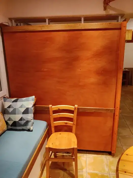

I have a tall cabinet acting as a room divider. Since it's not against a wall, it could fall. Screwing into the floor or the wall is not feasible, but the top of the cabinet is 5 inches from a concrete beam. If I could apply "reverse clamping" pressure between the top of the cabinet and the ceiling beam, that would push the cabinet against the floor, tacking it in place.
The solution needs to be permanent, so I won't be using woodworking clamps set to spreading. I'm considering wedging some wood in place with a hammer, but I'm having a flashback (or is it a dream?) to some kind of bolt with plates at each end that can be spread apart by rotating a nut in the middle.
Does anyone know any such device and what it might be called? Regardless, I'll take any and all ideas about how to engineer some spreading pressure. If it's ugly, I could box it in.

Here is what I did in the end
Another idea that occurred to me: adjustable feet, placing them at the top of the furniture rather than the bottom. Found some at the hardware store.
Thanks for everyone's contributions, I learned heaps of ideas for next time.
Shelf stabilizers Front of stabilized shelf Back of stabilized shelf
