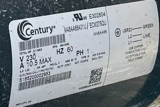

Pool Pump motorPool Pump/motor
Hot tub blower Hot tub blower

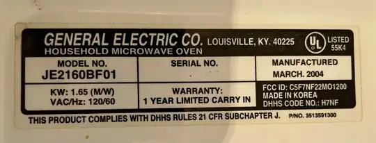

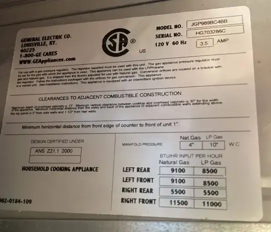

@ThreePhaseEel - regarding the two cooktop circuits, just tested and one controls the gas cooktop which has a kitchen exhaust-type fan built in; and the other controls the outlet (buried inside of the cabinet/space under the cooktop that has the microwave plugged into to it). CooktopCooktop
Microwavemicrowave
Connections for both (microwave plugged into the white face outlet, cooktop into the metal one): enter image description here

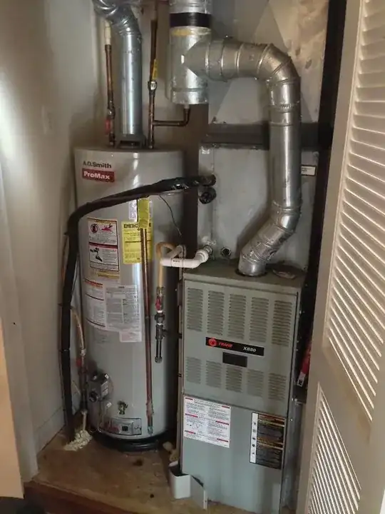

As best as I can tell, heating/furnace and water heaters are gas, but here are pics of them just in case. https://www.dropbox.com/s/b1p8j201uyesbec/Furnace_WaterHeater1.jpg?dl=0 https://www.dropbox.com/s/53zdvy2kjhpwk8e/WaterHeater1.jpg?dl=0 https://www.dropbox.com/s/hhi3c97a9lf0ag8/Furnace1.jpg?dl=0

  • @Alex -- what are the HP ratings on the pool pump and bubbler blower? – ThreePhaseEel Dec 15 '21 at 02:45
    @ThreePhaseEel Added pictures of labels of pool pump motor and the hot tub bubble blower. This has been a great exercise in getting all this info, although believe it or not I already had photos of a lot of these things without a need to go outside and take them. Hopefully this is enough info to do the electrical load calculation. Thanks – Alex Dec 15 '21 at 15:06

  • @ThreePhaseEel - I added pics of the cooktop and microwave labels, each of the cooktop circuits SABCs controls either the cooktop or the microwave. Does that make a difference as it pertains to the kitchen SABS and overall capacity? – Alex Dec 18 '21 at 14:52
