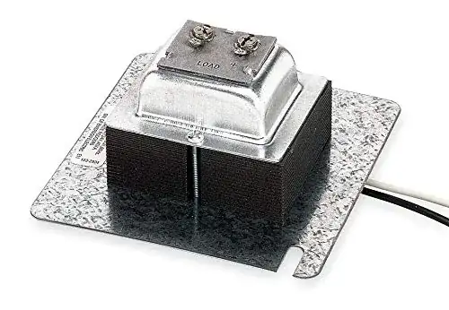

The Zone-A-Flow 1311 runs on 25V AC. That is also typical for thermostats in general - though many "dumb" thermostats don't even need any power at all. So what you are looking for is a transformer (possibly one for each zone). A typical White-Rodgers from Amazon:
Transformer
but brand doesn't matter, voltage matters.
Typically these will be powered by the same power for everything else in the HVAC system - e.g., electronic ignition, pumps, blowers, etc.
