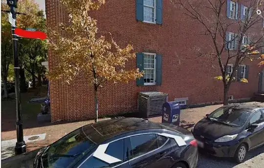

Not an answer, but this is the only way I could post a picture of a friend's house in the city, with the AC unit sitting on the sidewalk next to the house right behind the mail box. Yes, he had to go to the city to get a waiver to do that.
OP - Has your neighbor applied for a variance? That should be the first approach. Like others have said, almost all jurisdictions have a process whereby bulk requirements (like building setbacks) can be waived.
