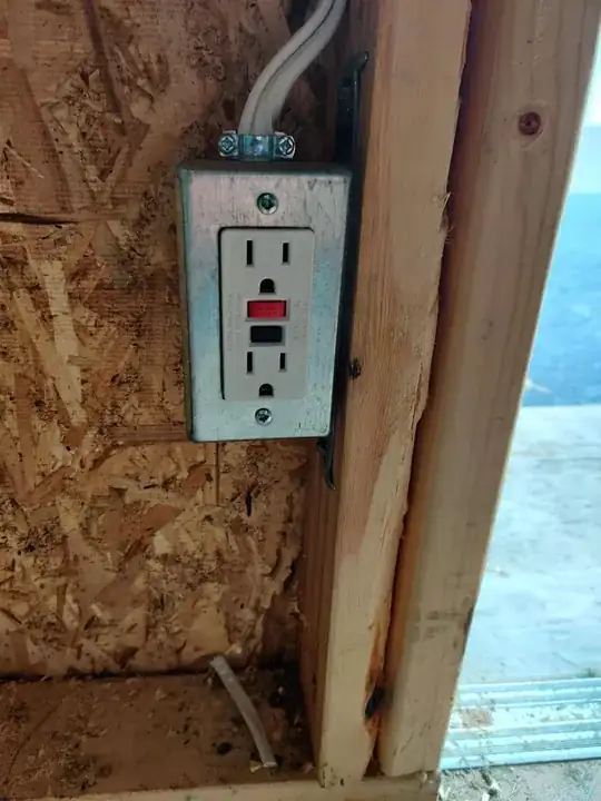

Original situation:
I have a 14/2 circuit, where the circuit powered 7 lights and 3 outlets. One of those outlets was in the kitchen and was powering a microwave and sometimes an air fryer. During microwave operation, the microwave sound started to sound lower in pitch occasionally suggesting to me that the circuit is overloaded or maybe that the microwave is going bad. I want to start at the circuit, because it is indeed underpowered for the microwave.
Appliance Usage
I usually use one or the other appliance, but not both. However, I might sometimes use both, but I imagine it will be rare, and so I don't know if it will be worth to wire up the circuit to account for using both, or using just one at a time. Also the way my appliances are positioned, both of them are plugged into the same kitchen outlet (the outlet in the photos).
Power stickers on the appliances:
  • Air Fryer: 1700W, 120 VAC, 60Hz
  • Microware: 60Hz, 11.5 amp, 120VAC
Note, however that when measuring amps directly the ammeter gave a reading of 16.4 amps at the highest for quite a while, and then it went down to 14 amp reading otherwise. I don't know if going from 11.5 amp to 14-16.4 amp is within the normal operating range of the microwave or if it is drawing more current because it is reaching its end of life or is faulty otherwise. I do plan to replace the microwave eventually.
Current Situation
I want to wire up a new outlet with duplex receptacles probably with 12 gauge wire that can handle both appliances. Chances are I will not run both of them at the same time, but there might be exceptions to where I do.
How do I best wire up this receptacle?
  • what AWG do I use?
  • what amp and type of breakers do I use, and where do I position them relative to each other?
  • what type of outlet do I use?
  • anything else I need to consider?
enter image description here enter image description here enter image description here enter image description here enter image description here

This is plainly a Siemens/Murray panel, noting the un-plated copper bus bars which are a signature.
Due to differences in bus bar spec, breakers not made for this panel should not be in this panel. The panel labeling lists all allowed breaker types, and I'm fairly sure GE THQL and Square D HOM are not on that list lol.
All modern 1" wide breakers will seem to fit each other's panels but won't engage to the bus bar properly, which can cause arcing and fire damage down the road. So the Square D and GE breakers (I assume there's an Eaton in there under a label, just to complete the collection) need to go and be replaced with Murray MP (now Siemens QP). We're talking $5 a breaker in normal pricing, so this won't break the bank.

    No comment on the alien invasion that has taken place in this panel?? – nobody Jan 06 '22 at 00:10
  • @nobody holy smoke yeah, I didn't spot that. – Harper - Reinstate Monica Jan 06 '22 at 01:57
    The "alien invasion" is a good reason to _not_ put stickers over the breaker bodies like that. Is that actually allowed in code or is that verboten, too? – FreeMan Jan 06 '22 at 14:41
