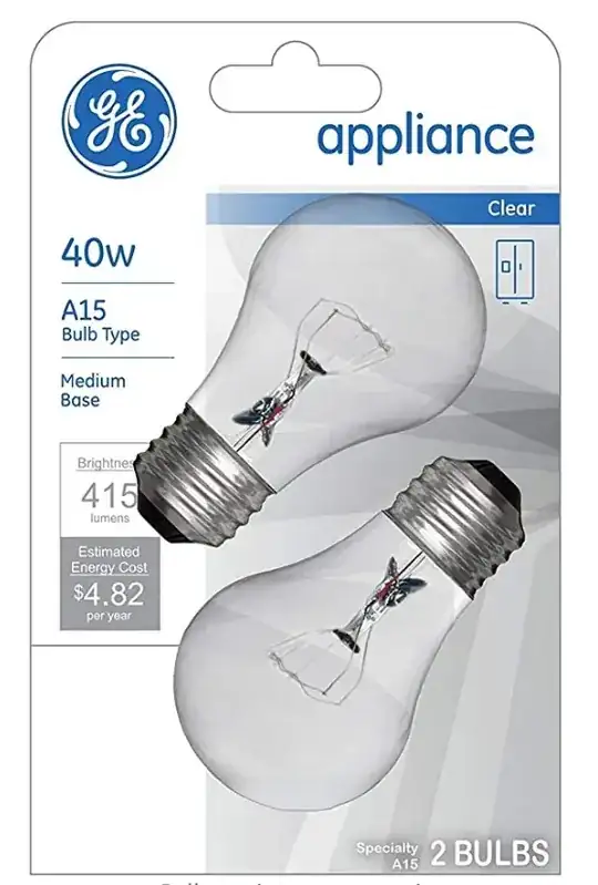

No, any 40W incandescent that is similar size and base will work just fine. I would buy these ones from Amazon. Replacement and a spare for $5.
Spehro Pefhany
  • 635
    Oddly, they show a refrigerator in the top right icon - somewhere it's actually much better to use a cool LED rather than an incandescent which will dump heat into the fridge. Curious that they elected to not use an oven or range for that icon... – J... Jan 07 '22 at 17:24
  • @J... I agree. I even got away with an LED lamp in a gas clothes dryer. Probably has something to do with making money rather than recommending the very best product. – Spehro Pefhany Jan 07 '22 at 19:32
