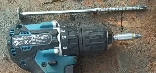

So instead, I'd say keep the corded hammer drill to make holes in bricks, and get a nice, small, lightweight driver-drill without hammer action. For example this one:
It's the smallest 18V brushless from Makita. I have big hands, but still, it's tiny. It will screw screws larger than itself into 5" thick wood, and it also has a very accurate trigger, so the small screws .
So basically, don't get the big drill just because you'll drill into brick twice a year. Dust off your corded one for that, and instead get a small light drill, 14V or 18V. I got the small battery instead of the big one, because it is lighter, and if you have two batteries instead of one, you can have a battery in the charger. With the 2-speed gearbox, you get a nice combination of speed and torque.
