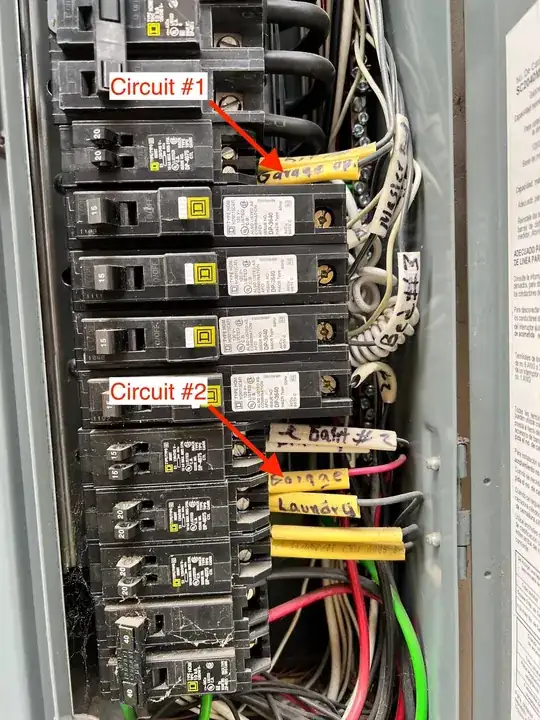

While moving some wires around in my garage (to make space for attic storage), I discovered an electrical issue that might be concerning: In my garage there are two circuits delivered as a MWBC, but the two circuits are on the same bus (0V between the red and black, 120V between each of the hots and the neutral).
The two circuits are sitting completely separate in the panel (see attached image -- I highlighted the two wires in the MBWC). Interestingly, when I called a local electrician for advice he said it's nonsense and should work fine just as it is, but from everything I am reading it is not only a code violation but also a fire hazard... What would be the easiest way to fix this issue?
One quick fix I could think of was to swap one of those tandem breakers with one below or above it, so at least the two circuits will be on different phases. My concern with that one is that I'd first need to confirm that the other wire on that tandem breaker isn't also a part of another MBWC... And I'm not sure how to do that. Any better ideas?
I have to admit I am quite surprised: We purchased this house new from a builder and have never modified anything, so the home was built this way, which seems incredibly careless.
Update: Just occurred to me that SolarCity (now Tesla) installed the PV system years ago and likely moved circuits around on this panel, so I suppose it's possible they created this situation.

    It is quite possible that someone who didn't know about the MWBC moved things around. That is actually the other benefit (besides common shutoff) of handle-ties (or double breakers): It makes it real obvious to someone working on the panel later that the pair should stay together. MWBCs have not always had that requirement. – manassehkatz-Moving 2 Codidact Jan 14 '22 at 02:13

  • Swapping wires: Swap garage and laundry in the "Circuit 2" breaker pair. Swap the garage wire from the "Circuit 1" breaker pair with the first wire in the pair below the "Circuit 2" breaker pair. That puts the two garage wires next two each other but on different phases.
  • Get a handle tie to connect the two garage breakers. I believe that is HOMTHTCP. That connects the two breakers together so that you have common shutoff which is required for MWBC for safety.

  • Thanks! That sounds easy enough, just hope I have enough slack in the wire to move those around without having to extend them. – ldoogy Jan 14 '22 at 02:08
    Key thing to remember is that your MWBC is 20 so you can only move around with the other 20A breakers/circuits. Extending a couple of wires is not a big deal - that's what wire nuts are for. – manassehkatz-Moving 2 Codidact Jan 14 '22 at 02:10

    Thanks @manassehkatz-Moving2Codidact! It's ridiculously overpriced for what it is, but I'll pay it (in fairness, I thought I would need a brand new breaker, so this is actually a smaller expense than I was expecting). Will try to get this rearrangement done over the weekend. – ldoogy Jan 15 '22 at 06:46
    Just a quick update: Got it done without much issue. Moved the two circuits so they're no longer on the same bus, and installed one of those little tandem handles. Thanks again for the advice! – ldoogy Feb 01 '22 at 17:55
