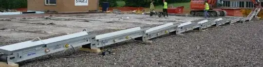

Depending on where you live, you might be able to rent a conveyor. This is a Miniveyor, available in the UK.
Miniveyor mini conveyor belt

  • Jewson quoting around £100 per 3m length per weekend. As an alternative, I remember seeing something years ago that ran on a standard ladder and was being used to take material to the top of a block being built: I wonder whether something like that is still available- or could be rigged up? – Mark Morgan Lloyd Jan 18 '22 at 11:41
  • @MarkMorganLloyd that's an elevator for lifting roofing. I doubt it would work as well when horizontal. Though, anything could happen. – FreeMan Jan 18 '22 at 12:32
  • @FreeMan I'm inclined to agree, and ladders abused by being used as horizontal track would have to be cut up and scrapped afterwards... but anything's better than a barrow. Having since spent a bit of time on (UK) plant hire websites, it turns out that it's possible to hire powered barrows with tracks which I suspect are narrow enough to fit OP's constraints: for that matter I measured up a mini-digger a few months ago and I think it was less than 1.4m wide. – Mark Morgan Lloyd Jan 19 '22 at 13:13
