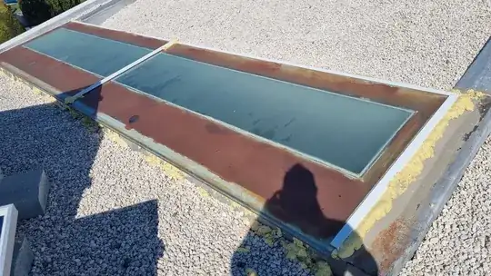

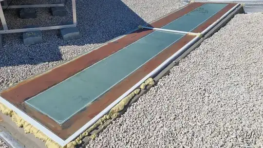

Attached are photos from the roof, as an FYI guys. This is a custom made window. The roof at that point is sloping, and the brown color was just a paint i did thinking that would make some difference... enter image description here enter image description here

If you simply cover the bottom of the opening with drywall/plasterboard/gypsum board, you'll still have condensation on the skylight, though possibly a little less because the drywall will slightly insulate the window opening. The difference is that instead of dripping onto the office floor/down the stairs, it'll get collected on top of the drywall. Instead of irritating you each night, now you won't notice until the drywall gets so soggy that it collapses onto your desk chair.
Insulating the cavity between the drywall and glass will help, but it's very much a short-cut way of doing things. It will likely have a negative impact on resale opportunity/value when it comes time for you to move on. People will look a the lovely skylight when they're looking at the outside of the house and wonder where it went when they're looking at the inside. They may wonder what other short-cuts/shoddy workmanship was done and it could scare them off from making a purchase.
If you really don't want the skylight any more, the proper thing to do is have it removed and have the roof patched in with plywood & shingled over to match the rest of the roof (or sealed and graveled, now that we have a pic of the actual roof in question), then insulate the cavity in the rafters, then drywall and finish the interior ceiling.
If you like the light but want better insulation, replace the skylight with one with double- or even triple-pane glazing, possibly Argon filled (for better insulation) and low-e coatings to help keep the UV out and the heat in.
A replacement skylight (whether just the glazing or a whole new unit) won't be cheap, but will probably be on par with filling in the hole with solid roofing material. Either will be less expensive than a hospital visit if you happen to be sitting in the office chair when the drywall gives way because of the condensation that's collected on it.
