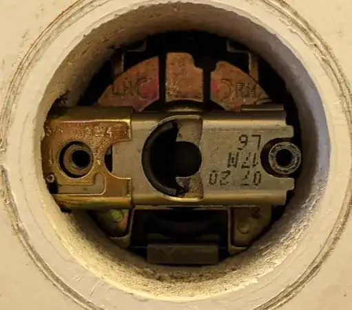

The following Kwikset lockset on my front door no longer works well. From the inside rotating handle it's fine. From the outside it's sticky, as the bolt does not fully pull in. This particular lockset replaced an older and more sturdier model a few years back. Nothing inside seems amiss. I've checked the backset and it seems fine.
Kwikset Hawthorne Single Cylinder Sectional Handleset failure
Kwikset Hawthorne Single Cylinder Sectional Handleset core

  • I have seen trouble like you are having with that type of leverset. It may take a simple touch of grease on the right places, sometimes the alignment is just not so so right. They can be finicky. Just thought, can the thumb press move in and out? It appears the lever that works off the outside thumb press is restricted to a degree. – Jack Jan 24 '22 at 07:09
  • Honest question, @Jack. Grease or some sort of dry lube like graphite or a silicone spray? Seems that inside the door, grease would be reasonably well protected from collecting dirt/dust, but could still get gummed up over time. – FreeMan Jan 24 '22 at 19:19
  • Those alternatives will as well. In the matter of grease, I don't know what particular "blend" may gum up over time, since there are a few formulas out there. I am guessing old fashioned moly, I think it is called. I have disassembled really old rim locks and mortice locks, the grease still doing as it should. I am leaning towards it being more of an alignment/leverage thing rather than lube. Although that should be done periodically anyway. – Jack Jan 24 '22 at 19:26
  • Rereading the question, this lock has been installed for a few years now, and now is acting badly. It may be a lube issue after all or a wear issue, which may be possible in a cheaper handle set. Something has happened to the inside of the hardware that changes the up and down motion, to a rotating motion to actuate the latchbolt. – Jack Jan 24 '22 at 19:31
  • could be related to temp, metal shrinking just enough to be a problem. – dandavis Jan 24 '22 at 20:34
  • I added lubricant, that just make it work more smoothly. The same problem exists. – Bryce Jan 25 '22 at 02:22
