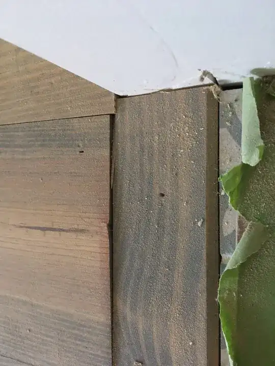

Have a relatively new 5 year old double storey townhouse. There is a long diagonal slightly jagged crack extending from the corner where the door meets the wall in the ground floor. It's almost 60cm and probably extended 30cm over the last few months. The base of the crack seems to have gotten bigger, maybe 5mm wide. The builder is insisting this is just settlement of the house but it seems more worrying to me. Pretty worried about the structural integrity of the house now. Do you guys think this warrants further investigation by a structural engineer or someone?enter image description here

    "The builder is insisting this is just settlement" - a new house shouldn't settle that much. The foundation work should have been done specifically to _prevent_ settling and should have been appropriate for whatever kind of soil conditions you have. This sounds like they're trying to get you to "go away" and not complain. That's all the more reason to complain even louder. – FreeMan Feb 07 '22 at 15:44
    Cracks at the joints of the drywall might be settlement cracks. A crack in the middle of a drywall panel is concerning. A structural engineer check is cheap insurance and a good opinion to go to the builder with. – crip659 Feb 07 '22 at 15:49

    @NPA - What country are you in? This can be important because certain types of building failure are **much** more common in some places over others. If you're in a country with lax building standards it's far more likely that this is both more serious and less likely to be resolved by legal disputes, etc. In many countries the correct response to a fault this serious would be to open a legal case with the builder, but where that isn't an option you may be looking for more practical advice about how you can best fix this. More information on the circumstances would be helpful. – J... Feb 07 '22 at 17:24
    It would also be helpful to see outdoor photos of the house with indications of where the wall is with relation to the outside. It would also be helpful to know the structure and orientation of the house and the wall with respect to it. This may be something as crazy as a non-structural wall that is taking load inappropriately for some reason, for example - impossible to say without more information. More detail is always better. – J... Feb 07 '22 at 17:25
  • ...Did someone try to close that crack with - tape? Can't imagine that'd be all that effective... – Darrel Hoffman Feb 07 '22 at 17:54
    @DarrelHoffman looks to me it's marking the current and former ends. – Reid Feb 07 '22 at 19:51
  • Can you take a photo from further back? Trying to see the context. Its unlikely to be a diagonal join, but not impossible. – Criggie Feb 07 '22 at 20:10

It's a bit difficult to tell since your photo has no context. But generally cracks in drywall, especially at the joints, are common and nothing to worry about.
In this case, however, there is clearly something going on behind the drywall that has cracked it and it does not, to me at least, look routine. This is especially true as you indicate that the crack is still forming.
I'd be looking at what's under the floor near this wall. Is the foundation subsiding? Was the home improperly supported to begin with?

I'd be more worried about the lintel and/or its supports by the door's top corner.
I'm here in Ireland, so if it was an old stone/block/mass-concrete house I'd say that the timber lintels were sagging. But as it's a new one, this should not be the case as lintels for traditional masonry walled houses have for many decades have been steel reinforced concrete and should neither crack not sag. With new timber-frame houses, it's a sort of timber stressed-ends beam lintel with the bulk of the stress borne at the upper and lower end of the beam.
Yet, wherever you are and whatever the way the house is built, something is out of line when a crack like that opens up. So call a building surveyor or structural engineer in immediately. They may well be able to deduce that the underlying problem has been there from the outset. In other words, it's a build quality issue and compensable if the builder is still in business.
So call the surveyor/structural engineer today.

  • I'd be curious if the crack has propagated below the surface, into whichever material it covers. As it'll have to be plastered anyway, you could remove a little around it to see what's happening below. But yeah, chances are something structural is going on, so you'll probably end up getting a professional anyway. – MiG Feb 07 '22 at 16:16
