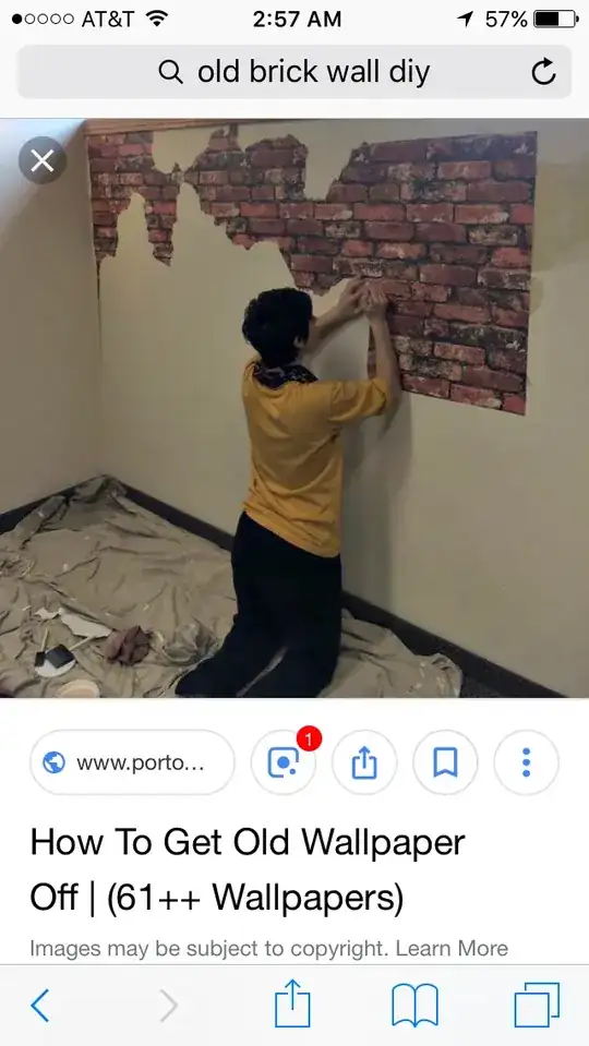

We've actually issued mortar as an adhesive for tiles before. They were 2x6" tiles made to replicate the look of brick. I applied them to the wall in a brick style of layering. I mixed the mortar based on the vag's instruction. Spread about a 1/4" thick layer of mortar across the bottom right side of the wall, and tiled mostly from right to left, bottom to top against a vertical wall. The mortar mix was virgin (no additives like tints, glues, etc.) I was tiling against a vertical wall of drywall that had knock down texture and at least one coat of satin based paint on it when I bought the house. I repainted another coat of satin based paint two years before tileing it. And I laid the tiles in in the common brick pattern. Long side from left to right and the short side from top to bottom. I can't say how the affects of the mortar played out over a long period of time because I only owned that house for about 2 years after the brick when in. There was one small (I think 4.7?) earthquake in that period of time, and no damage that I was ever able to see. It held steady and looked crazy cute, if I do say so myself . So... in retrospect... 1. If I didn't want that brick to be on the wall anymore I would have had to tear out the drywall and completely replace it. That may be annoying if you can't afford to match the texture from the rest of the room. I am actually about to make a similar look in my new house. But I'm going to try using D.A.P. "Kwik Seal Plus" as the adhesive for the tile. I'll use a calking gun to apply it to my tile, then I'll apply some to a piece of "peg board" I bought in sheet form and cut to fit the area I want to look like brick. When the calk adhesive is dry, it has a flexible hold. I'm hoping that will cushion any movement made by hanging such a large heavy piece against a stationary wall, and then drilled into place with wood screws. Then I will fill in the spaces between the tile by working mortar or cement into the crevices with a trowl and a damp sponge to clear the face of the tile from some of the sediment. Working in a circular patter will let me stop when it is 98% finished. I'd like to leave the edges of the brickwork/tile with a little bit of an "old shabby chic feel to it. I attached a photo to give you an idea of kind of how I want it to look when I'm finished. Anywho... thanks for letting me add my 2¢. Happy Hplidays and Merry Christmas, ~Sheeara 12.3.2018enter image description here

    Hello, and welcome to Stack Exchange. Although this is interesting, it is more a story than an answer to the original question. If you cut its size by about 80% it'll be much more useful. Thanks. – Daniel Griscom Dec 03 '18 at 12:26
