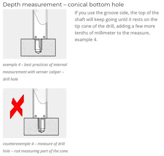

The narrowing allows you to avoid the rounding of an edge (e.g. of a lip) or the rounding of a conical hole bottom (e.g. of a drilled hole).
Or you can opt to deliberately measure the depth at the edge or bottom before any rounding.
This is also why the narrowed protrusion is offset to one side, e.g. in your picture it is aligned with the bottom of the gauge, and not centred.
A drilled hole's depth is generally the depth at full diameter, so it's measured along the wall. The blind hole is measured at its flat bottom, and any rounding (perhaps due to a fillet of grime or crud) at the bottom corner should be avoided. Important thing is to be aware of these subtleties in order to make the measurement that matters for the case at hand.
Depending on how it's held, you can aim for an offset or not and either way run it tight along the edge for a straight measurement.
Ref: https://www.stefanelli.eng.br/en/use-vernier-caliper/

  • #TIL! I'm curious, though, for the blind hole measurement, how would you do it any other way? – FreeMan Feb 11 '22 at 18:39
  • @FreeMan a drilled hole's depth is generally the depth at full diameter, so it's measured along the wall. The blind hole is measured at its flat bottom, and any rounding (or grime) at the bottom corner should be avoided. Important thing is to be aware of these subtleties in order to make the measurement that matters for the case at hand. Or perhaps I am eagerly writing what was already glaringly obvious to you... – P2000 Feb 11 '22 at 18:52
  • Ah! I see now. The notch in the depth rod goes over the crud making a fillet at the bottom of the hole. Nope this was _not_ glaringly obvious to me. TYVM, +1 again, if I could. – FreeMan Feb 11 '22 at 18:56
    @FreeMan better than an extra +1 is the gift of a new word "a fillet is a rounding of an interior or exterior corner of a part design" which was precisely the word I was looking for... – P2000 Feb 11 '22 at 19:45
    Well, there you go, we _both_ learned something today! – FreeMan Feb 11 '22 at 20:05
