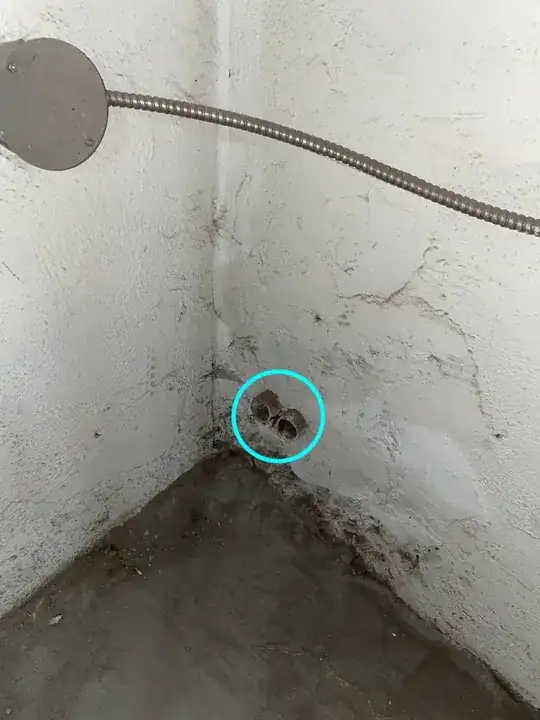

My questions are about the pipe circled in orange, and the 2 pipes circled in blue on the back wall. We probed the orange one and it goes down ~ 2 feet into the ground and seems to hit sand afterwards. There was, however, a faint oil smell on the probe afterwards. The 2 blue pipes seem to be encased in the concrete wall and don't lead anywhere.
  1. Orange pipe: Is it possible that this pipe leads to an underground storage tank? Or, is this more likely simply a drain pipe, and the oil smell is due to small leaks and spills that have occurred in the past from the above ground tank? A relative mentioned it would not be logical for a tank to be buried in the furnace room, way below the level of the burner, as these systems relied on gravity to bring oil to the burner.
  2. Blue pipes: Could these be lines that brought fuel from the above ground tank, through the concrete and up through the foundation wall back to the burner? I am not sure if this would be a likely set up, or if these pipes are something else altogether.

Blue
Lines were probably hooked up to the oil tank so that deliveries could be made without needing access to the house.
These do seem oddly low considering that fact that tanks are filled from the top but as long as the fill spout outside is above your tank then gravity will take its course no problem.
