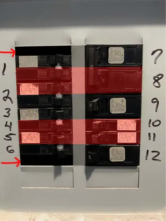

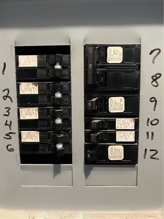

Here’s a pic: pic of panel

  • A MWBC is going to be on two sequential even or odd numbers. Not simply sequential numbers like 5 and 6, unless your panel is older than I am. – Mazura Feb 15 '22 at 03:54
  • @Mazura Maybe I am wrong? Is it on the same leg and just double stuffed? – Joe Feb 15 '22 at 04:00
  • Double stuffed is definitely the same leg. But there wouldn't be a handle tie. Your 5&6 are the same phase/leg and should not share a neutral. 7&8 is an example of how you get the two different phases; a two pole breaker. *That* can share a neutral (or not even have one). - Never seen those little white things before. – Mazura Feb 15 '22 at 04:04
  • Wait. Everything on the left is half a slot off. IDK what I'm looking at here. – Mazura Feb 15 '22 at 04:07
  • @Mazura Yeah, IDK what's going on there either unfortunately... but perhaps that means the different phases are on track. Hopefully I'll have time to test in the next day or so and see if Greg's answer below confirms that... – Joe Feb 15 '22 at 04:09
You can tell by how the panel is phased.
Service panels have their 2 phases (poles, really) laid out in a very particular way.
You have a GE panel. It's a little odd, but still decipherable. Let me stripe it for you like in the link.
Yup, 5 and 6 are on opposite poles. Note how GE does double-stuffing a bit different. Note also the Code violations; the empty holes at breaker 0 and 6-1/4 need to be filled with GE approved blank plates. The easiest-to-find models of blank plate are THQP115 and THQP120, which are also breakers LOL.
Now, watch Technology Connections' video on how we use 120V and 240V, and particulary his measurements on how breakers are phased. I cued it up for you. Notice how breakers on opposite poles are 240V from each other. Don't open your panel; you don't own that house.
So now it's a simple affair. If you can just measure voltage from the hot terminal of the microwave from the hot terminal of any other candidate socket... if the voltage difference is around 0 volts, it's on the same pole of the MWBC. If it's around 240V, it's on the opposite pole. Mark your receptacles in some manner.
To measure at a socket, just insert the UL listed and 600V rated voltmeter probe into the hot terminal. On a NEMA 5-15 or 5-20 socket, you already know ground... neutral is the taller one (or T-shaped one). The other one is hot.

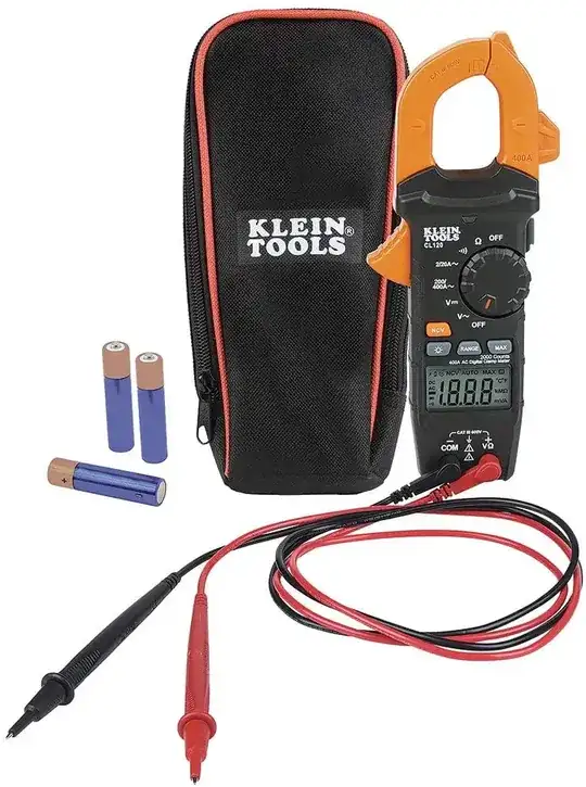

FreeMan's answer is the standard way to do this. There is one other option, which involves removing the front panel of the breaker panel (which you may or may not feel comfortable doing) but does not involve disconnecting any wires.
  • Remove the front panel. This is usually pretty easy as it needs to be done any time a breaker is added or changed. **Be careful. Keep metal (rings, watches, tools) away and stay away from the feeder (usually at the top or bottom, and usually connected directly to a big breaker).
  • Get a clamp meter:
Klein CL120
  • Get a helper
  • Unplug everything from all 5/6 receptacles.
  • Have the helper plug a reasonably high powered device (e.g., a lamp with incandescent bulbs - remember those?) into each receptacle
  • Measure the current on the hot wire going into each breaker (5 & 6) to determine which receptacles are on each breaker
  • Thanks - I do have a clamp meter (that one, I think!) and might do that if FreeMan's solution doesn't work or we run into any issues with still-energized circuits. (For what it's worth, mostly the electrical here was done "minimum code" but still code, so odds are it'll be okay... but still obviously being very careful!) – Joe Feb 14 '22 at 20:32
