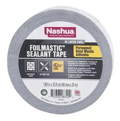

Most foil tapes are absolute garbage and the adhesion doesn't don't last much longer than one season if you're lucky.
I use Nashua Foilmastic tape for straight runs such as seams along straight pipe and where one pipe inserts into another.
For elbow bends I get a pair of cheap-o latex gloves and lather on some mastic. Make sure you're wearing clothes which you don't care about because mastic does not wash off. If it gets on your clothes then just let it dry and maybe you'll be able to peel it later.
