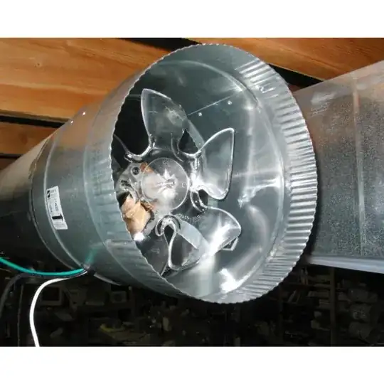

It's a junction box for some item installed in the duct (based on the "other" wires appear to go out the back into the duct.) Terminology wise, we tend to reserve "pipe" for a round tubular object with a bit more structure used for carrying water or gasses at pressure, while duct refers to the thin sheetmetal for moving air at barely any pressure around the house. You have a duct there.
That might be a duct booster fan, or a motorized damper, off the top of my head for most likely in-duct electrified objects, though the booster fan is more likely since damper actuators (the powered part) are usually external to the duct.
Booster fan image from phyxter.ai, whoever they are.
  • This is great, thank you for the answer! And sorry for the lack of vocabulary, moved from France a couple of years ago so I'm not yet super fluent with technical terms :-) Quick additional question: would the fan constantly work? I'm surprised it's running while the heating system is entirely off - no air flowing anywhere in the house. – Greg Feb 18 '22 at 17:27
  • Far better than my French, to be sure. No problem. Learning is good. Normally these fans are run with the system fan, not independently, but that's "normally" not "universally" - or there may be a failure in a control causing it to run. Or it might be part of a continuous ventilation setup separate from the actual heat delivery, even though using similar ducts. – Ecnerwal Feb 18 '22 at 17:31
