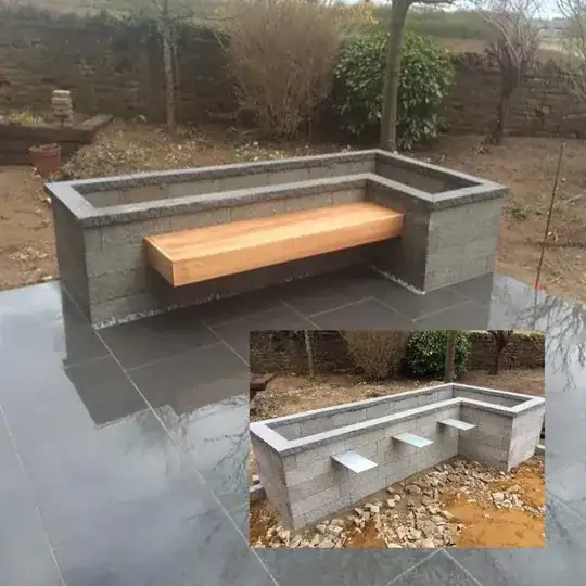

I am looking to make a floating bench that spans a corner. 10' either way. I recently built an L-shaped block wall with steel supports embedded within the concrete. Now, I need to build the bench.
Here is the wall: a PE engineer conservatively calced the point load on the ends of each 3" x 1/2" steel support at 580 lbs before sagging. My intent was to overbuild. CMU block spacing limits the span between each support, but they're no more than 28" apart. Each steel support is tied directly to the 2.5' x 2.5' footer via #4 rebar and horizontal #4 rebar cross members pass above and below the steel supports. The wall was then filled with 5000psi concrete. It's still green, but it's at ~20 days cure time.

Here is what I am attempting to emulate:
The first one uses what looks like 3 or 4 4x4s embedded in the wall to support 2x4s. The second one uses 6" x 1/4" steel plates at 30" spacing to support 2x4s with a 2x6 skirt.

  • A 2x10 is not going to have the rigidity to hold people up in a cantilevered setup like that without a lot of springyness. You'll need to make the thing out of metal. Floating shelves/etc are not easy, they are extraordinarily structurally demanding. – whatsisname Feb 21 '22 at 15:42
  • And without seeing details of the wall structure and supposed supports I can't be confident even a rigid metal floating bench would hold up. – whatsisname Feb 21 '22 at 15:44

  • Something to consider: [The Sagulator](https://woodbin.com/calcs/sagulator/) says that a 300 lb load (a big guy) centered on a 2x10 spanning 28" will have a 0.1" sag which they consider unacceptable for a shelf that is _not_ supported at the ends. I picked Eastern White Pine as an example of your general purpose construction SPF lumber. At a minimum, the inner corner won't be supported at the ends, and I don't know if you're planning a cantilever at the outside ends or not. For the spans between metal supports, they calc 0.02" of sag which they say is acceptable. – FreeMan Feb 21 '22 at 18:08
