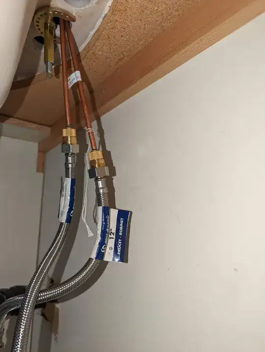

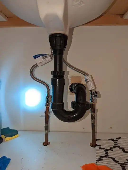

Update 3/10. Adding here due to size.
I've completed both sinks and the faucets and drains are functioning fine.
  1. I used Sharkbite fittings instead of a compression valve as thats all HD had at the time. Since this was time sensitive I went with a pair. Otherwise I followed HoneyDo's steps. I marked 0.95" to ensure the fittings were pushed all the way.
  2. I made a very clean and careful cut using the pipe cutter. After running my fingers around it (inner and outer) I did not feel sharp edges. However I still used a deburring tool (1.5-2 turns) and it was smooth,
  3. I cut the pipe at its smoothest point where there was no solder residue. Felt uncomfortable using a steel wool pad or Scotch Brite pad as I felt it would make the pipe "thinner" therefore increasing leak risk. But all guides advised to use it so I did sparingly.
  4. Is this level of bend/flex in the supply pipes OK?
  5. The faucet had soft copper pipes which were annoying to work with. I felt they would break any second but I was as careful as I could be.
Here is the 2nd faucet that I shared in the original post. This marks the project complete. enter image description here

    Looks good - the flex in the supply lines is fine. – Armand Mar 11 '22 at 05:27
    Leaving the labels on the hoses may look shoddy, but it's a huge convenience to the next person who may have to replace parts under here since the threading is indicated on the labels. Makes life much easier, and future you will appreciate it! – FreeMan Mar 11 '22 at 17:10
  • Soft copper will bend **a lot** before it will break. That's the point of it being soft. It can be adjusted to any convenient position. Just don't kink it (make a very sharp bend.) – Ecnerwal Mar 11 '22 at 17:23
    The 2nd faucet took 1/3rd the time. This was my first plumbing DIY and I enjoyed it - more so because this was for my child that can now easily use the faucet. I placed leak detectors under each sink and one went off the next day, turns out the faucet escutcheon was not aligned which I quickly fixed. Is it normal to stop and stare at your first DIY every few hours? Thanks for the responses everyone. – eszed Mar 12 '22 at 04:13
