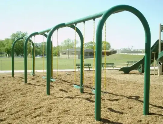

19
With 5 150-lb kids, I'm assuming we're now talking about teenage boys, all swinging together and in phase, your problems will be
  1. Anchoring. You'll need concrete anchors and to tie them to the set with brackets that are just as high quality as the ones at the top.
  2. Rot. Hoping you used treated wood. Even so, bees, ants, squirrels will all beaver away at it (assuming you don't have actual beavers). Keep a close eye on the condition of the wood, especially the beam.
  3. Dynamic Non-vertical forces. The beam may support 750 pounds statically, especially if you re-enforce it with another beam. The top brackets are well designed so that you have solid steel and wood, not screws, supporting the weight. But if the kids are all swinging together, you are now double or triple the vertical force on the beam, and you rely on the tear-out strength of screws to prevent the brackets from coming apart and on unpredictable lateral forces on the beam that might cause it to tear in unpredictable ways, especially when it's older.
IF I wanted a set that is entirely swings (no fort, ladder, etc ... all swings) and for five people (five all swinging at once) I would not do this!. I would purchase a commercial steel set and pour heavy concrete anchors for it.
Even this extremely robust one does not rely on 4 legs and a single span for five swings. And I have no doubt the main beam is strong enough. There are other reasons that this one uses multiple sets of legs and shorter spans.
