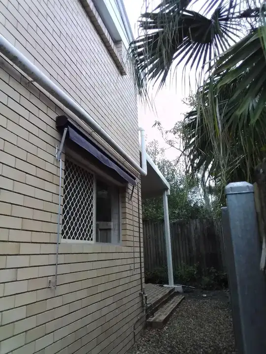

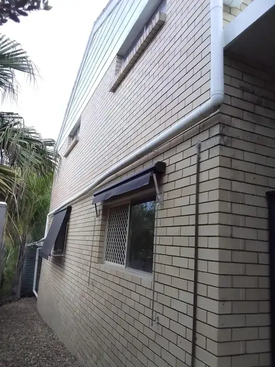

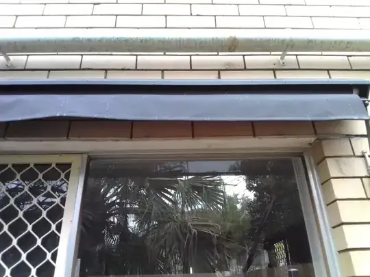

There is some not-so-small amount of rainwater entering our basement from the top of a window. I have checked the roof and gutters and fixed all cracks in the mortar between bricks on the exterior wall. I have also sealed around the window carefully. I can't find where the water can get through. The problem seems to be an old one as some timbers around the window frame have rotted.
The house is two story. The lower level walls are double-layer brick but the upper level is single-layer. The double-layer brick walls do not seem to let any water through. I suspect the water soaks through the upper level wall and accumulates on top of the window.
How common is it for rainwater to penetrate brick walls and what is the best solution?
The house is built in early 1970s, I don't see any weep-hole anywhere on the wall, and we never get snow or icing conditions. Here are some photos from outside and inside:

EDIT: As you've now added some pictures, whilst it's hard to tell, you have what I'd describe as "deep pointing". That is, there's a little space between the edge of the brick and the start of the pointing. There's nothing wrong with this, but it may mean that you have a little "shelf" for rain to accumulate on - and it then be able to seep through the pointing.
It's not a nice job, but after some rain, if things seem wetter than usual, then have a run around the pointing with the end of a screwdriver or something and see if there's any soft pointing. Don't hack away at it, but just see if there's any pointing that's a bit soft and comes away easily (ie. it's a bit like compacted wet sand). If there is, then it may be letting water through.
