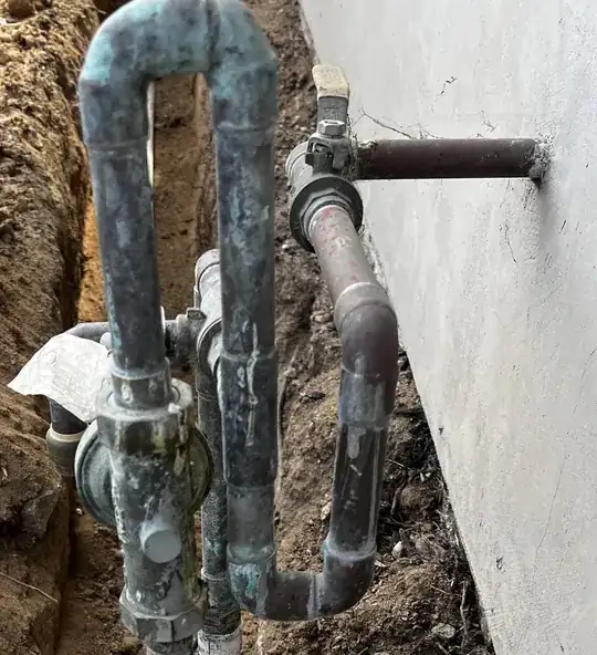

I also removed what I would best call an S-curve in the copper pipe after the pressure regulator and before entering the house. I had googled it and couldn't find anything about why it was there but maybe it acted as an air chamber - not sure. I removed it since it seemed unnecessary and only there to line up the pipes. This then let me put the whole unsightly assembly in a valve box underground. Here's a pic of the before:
And after:

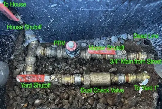

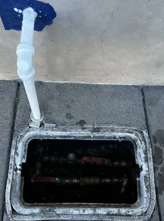

Water comes up on the right, into a ball valve, into the pressure regulating valve (PRV), then tees up to the house via ball valve, and down to my yard's irrigation / hose system after a dual check valve. There are pressure vacuum breakers before the sprinklers.
Now, when either the master shower is turned on on the second floor or the hose is run from the end of my irrigation line, the pipes in the opposite end of the house on the first floor (near where the water enters the house) start to vibrate / chatter and make a lot of noise. I have just discovered that the noise seems to be coming from where the main takes a 90-degree elbow and moves into my main shutoff valve and the PRV. Please see the Youtube video of the vibrating here and see it in more of a closeup with a focus on the the vibrating stopping and starting here.

As suggested below, I tried slightly closing the valves, but that didn't seem to do much. I then tried to adjust the pressure bolt on the PRV and it seemed to work for when the hose was on. I tightened the bolt until the vibrating stopped, but then when the irrigation kicked on it starting vibrating again. So, I adjusted it again and this setting only stopped the vibrating when both the hose and irrigation were on. I found something else my experimenting: when I turn off the valve to the house, there is no vibration at all.
I would have to guess that either the new pressure regulator valve or the removal of the S-curve is causing this. I can't tell if this qualifies as water hammer. Does that sound right and how could I stop this from happening? Would I have to re-add the S-curve and remove the valve box? Add an expansion tank? Remove the dual check valve? Better secure the pipes in the wall?

  • I replaced the PRV with a higher-flow unit and this seems to have stopped this condition. I'm attributing it to either a bad PRV unit (even though it was new) or like stated below, there may have been the perfectly imperfect amount of pipe between the 90 from the main and the PRV causing this resonance, and therefore causing the vibrations / chattering. – pennstump Apr 13 '22 at 18:11

  • Replacing the PRV removed the vibrations from the system, but any water running on the system causes some substantial noise inside the house where the water line enters. I think it's concentrated at the T split in the box underground. Is there anything you can think of that I can do to reduce this noise? Can a T joint be somehow baffled? – pennstump Aug 16 '22 at 20:10

That's definitely not a water hammer situation -- those are characterized by the bang of a sudden impulse followed by a decaying ringing effect. In your video the pipe is at rest and then we actually see the oscillations grow over a half-second or so. It looks quite smooth; my earlier guess of valve chatter might manifest more harshly. This looks like resonance -- the mechanical equivalent of a standing wave oscillation in an electric circuit.
A technique in circuits (transmission lines in particular) to tune or de-tune so that resonance will or won't occur is to add "matching stubs" to the line. An article at WaterWorld about acoustical resonance in pipes suggests this technique can be appropriate for hydraulic (water) systems too. An attempt to calculate the length of a stub for your application is far beyond the scope of an answer. I would guess that if there's a place you can easily add a tee indoors or outdoors then you could add an arbitrary-length pipe stub and see what happens. It's entirely experimental -- if I were doing it I'd start with something long, say 7 feet or so. If it doesn't have a positive effect then cut off several inches, re-cap, and test again.
The S-curve you removed might have been helping to suppress this condition. Whether it was just dumb luck or was an intentional fix is impossible for us to say.
