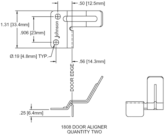

You can use any of the options listed above but they are not strictly speaking necessary. French doors have whats called an astragal (the strip on the passive door that overlaps the swing door) that unifies the two doors when closed. In addition the passive side will have a flush bolt top and bottom that drives a tab into the header and threshold.
flush bolt
(source: door.cc)
You can arrange your closet door in this fashion but I've never seen it done that way for a residential closet, its just overkill. Most of them have twin ball catches on top (shown above) and nothing on the bottom, or a bi-fold style door aligner on the bottom that ensures the doors stay flush.
door aligner
(source: johnsonhardware.com)
