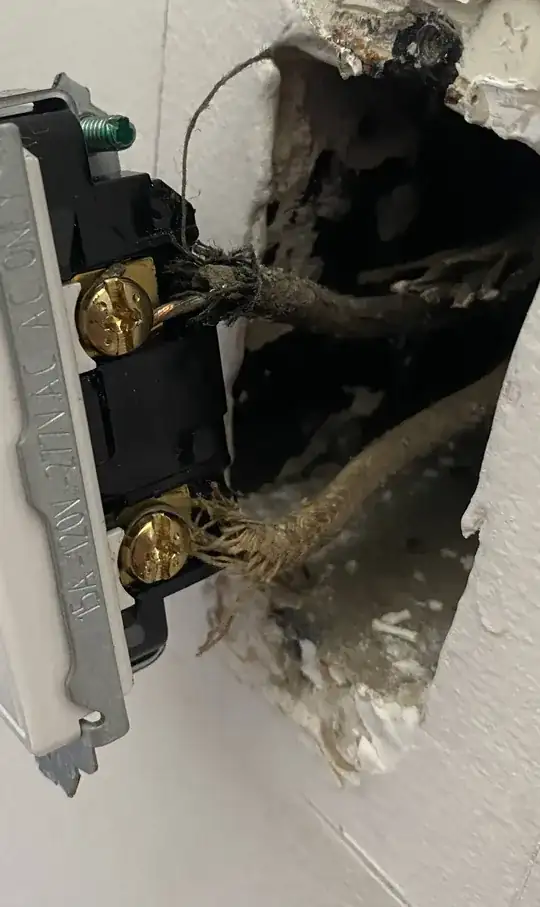

How can I fix this so that the pull string fixture is controlled on its own? wiring at the switch

You wired your new light to a switched fixture. Which is fine if you want another switched fixture, but that's not what you want.
So you need to locate a source of unswitched power and wire the new light from there. The light switch is one possible source (if new enough to have neutral at the switch.) It's also possible that the switch is fed from other wires in the light you already ran to, (via a switch loop, old or new style) and one of those is unswitched power.
  • I added some pictures of what I’m working with. Problem is that this is on the second floor of my house. In my attic I noted that most of the receptacles are switched. I have a spacepak system in the attic too that has its own box. Not sure if I can just tap into that? – Matt Mar 16 '22 at 17:02
  • My, that's some *bleep* old wiring. The potential upside, not that that I can see what I'm looking for in the light box, is that the switch appears to be an old style switch loop. So the Switched hot to the light (where our new wire is connected) should be coming from a cable where the other wire (should be "white" a bit hard to tell with your old cloth at this point, and frequently done wrong anyway) is joined to the incoming power cable hot/black (which cable should have its white connected to your "neutral" bundle.) That should be the unswitched hot. – Ecnerwal Mar 16 '22 at 17:30
