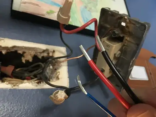

Following crip659 recommendation, I finally mustered the energy to move washer and dryer out of the way and open up the 240 outlet, which of course is located in the most inconvenient spot to reach. It was a worth effort, because it led to some important discoveries.
The first one is that in its current configuration the outlet is very dangerous: it has a plastic box, but both its face plate and frame are metallic. And not "grounded" (i.e., for a 3-prong dryer circuit, not connected to neutral) as revealed by a continuity test. Additionally the isolation of the wires is not in the best of shapes Dryer outlet plate
Dryer outlet plate
Damaged wires
Damaged wires
The second discovery is that, as crip659 hypothesized, the dryer outlet is indeed fed by a NM cable with a ground conductor. However it appears that some sadist took pleasure in cutting it short, in such a way to completely hide it inside the cable sheating. This happens both at the outlet end as well as at the breaker panel end. Why would anyone go so out of his way to make sure that no ground connection can be made is beyond my comprehension. Tip of the ground conductor inside the outlet
The fix on the outlet side is an easy one. I would just cut off the damaged ends of neutral and hot wires and move the outlet by a few inches to account for the shortened conductors.

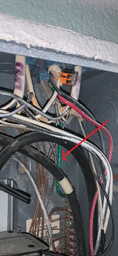

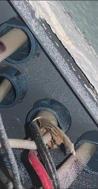

The fix on the other end, however, is something that worries me more, because my panel does not appear to have a turn-off switch. Breaker panel
Breaker Panel
Dryer wires in breaker panel
Dryer circuit wires inside breaker panel
Tip of ground conductor entering the breaker panel
I would not want to touch the breakers or anything connected to a live wire, but I can of course switch all the breakers off and work only on the de-energized side.
Off the top of my head I can think of two potential easy fixes, none of which is particularly elegant. I would appreciate any comments/critiques/suggestions on their merit and code-compliance
  1. If the length of the ground conductor inside the breaker box is sufficient, I could use a Wago 221 2-port connector and a 10AWG bare copper extension to connect to the ground bus (is a Wago connector allowed inside a breaker box?)
  2. I could create a junction box next to the breaker panel, splice just the ground conductor, route it to the breaker panel through a convenient knock-out and connect it to the ground bus. In this case, I'd probably use a shielded green 10 AWG wire labeled as "Ground conductor of the dryer circuit".
Any thoughts?

@pmont unfortunately the leftover wire was too short and did not leave any room for crimping. There was barely enough space to close the lever of a Wago connector, but I managed to get it seated all the way. I pulled pretty hard and the connection did not budge. Here is how it looks. The Wago connector
The connection at the panel entry
The final result

It's obvious the dryer guy did not install this panel. It appears to be fed by a 4-wire feed - note all grounds and neutrals are carefully segregated. So this must be a post-2008-style subpanel fed from either another panel, or a main disconnect/breaker elsewhere. (in NEC 2020 style; some cities have required this for 50 years, probably the same reason for the 4-wire feed). So look for a main breaker or main panel elsewhere.
Despite the age, it's not a split-bus panel because it's apparent the panel is all original, and all the 240V breakers have been put down the right side (a best practice that's impossible on split-bus). So, main breaker elsewhere.
If you can't find a main disconnect, all these breakers "rock out" - push further outward on the handle and the whole breaker will unclip from the bus (which is in the middle). Then the heel comes off its little hook and you have a breaker in your hand with wires attached to it. (which is fine; it became de-energized when it unclipped from the bus). This, by the way, is why backfeed breakers must be bolted down. So you can pop breakers off a live panel, change their wires with the breaker in your hand, and snap them back in. Have the breaker be off so it doesn't arc when you clip it on.
Note that you need a torque wrench or driver to set the screw torque correctly. (NEC 110.14). That's serious business that has been traced to many wire burn-up's.
Unfortunately, you'll be doing this a lot. Challenger panels are fine, but Challenger breakers had a VW-like scandal where it turns out they had rigged their UL testing. So they don't trip reliably and must be replaced. The good news is that BRyant inherited the bus design and kept it for their own BR breakers, and their line is made by Eaton. Eaton BR is the most popular breaker line in America, and if you look on the breaker it says "Type BR / Type C" (you need Type C).
So all the breakers need to be replaced, but it's still under $100 for all of them. That's about what you were going to spend on the 2-pole GFCI!
