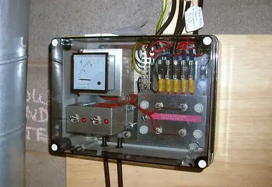

It is good idea to make a Distribution Board just like the ones used for high voltage and use circuit breakers. With cat Cable (26AWG) you want 0.3A to be safe - the rest is up to what cable you decide to run.
But even a DIY one like this will work very well and ensure safety against short circuit, over current with the ease of monitoring consumption. You can even run 110/220 into this DB and incorporate a fail over, in case your batteries run down, so you could then have a simple sensor, relay and a 12volt 2~5a power converter.

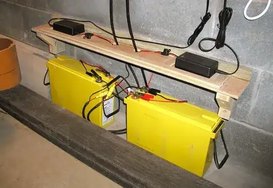

Just one thing to remember - If you are using acid batteries do not leave them on concrete! Always place them on top of timber or elevated. A strange thing happens that acid batteries discharge when placed on concrete/ground and should not be close to earth. Not sure about dry cells.

    MK battery corp says this: Many people have the impression that when batteries sit on concrete, energy “leaks out” or they are ruined. The short answer is that letting modern batteries sit on concrete does not harm or discharge them in any way. In fact, concrete is generally an excellent surface on which to place a battery. The electrolyte in a battery sitting on an extremely cold floor with very hot air around it could stratify, causing damage from sulfation; whereas concrete provides good thermal mass to buffer any temporarily extreme temperatures in the battery compartment. – Philip Ngai Jan 30 '13 at 17:19
  • the keyword being modern batteries. What is the definition of modern battery? – Piotr Kula Jan 30 '13 at 20:28
    Anything you can buy today! – Philip Ngai Jan 30 '13 at 21:00
    All batteries that do use plastic instead of tar for the package. – Gunnish Jan 31 '13 at 11:17
  • Wierd- When I used to work a while for a auto body repair shop - I experienced this discharge with the so called modern batteries you can buy today? A new fully charged battery that stood overnight on concrete was D-E-D the next morning? So I still stick with my opinion. Dry cells wont do this I know – Piotr Kula Jan 31 '13 at 11:24
    The old rubber coated batteries did discharge when placed on concrete that's where the notion that a battery would discharge when left on concrete, the other part why people still believe this is they have a battery that is sulfated (low internal resistance so it discharges on its own) kept the idea alive. A good battery that is charged in a plastic case will not be affected by placing it on concrete. A lead acid battery creates voltage by use of dissimilar metals and chemicals. New batterys have a very high internal resistance as they age this value is reduced and they self discharge. – Ed Beal Mar 09 '18 at 16:14

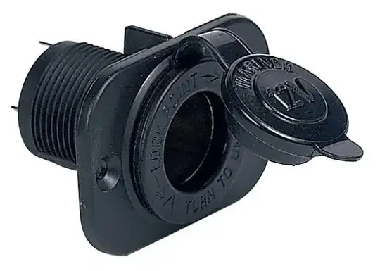

A widely-used standard for DC outlets is the "cigarette lighter" plug. If you install them in your walls, I recommend labeling each one with the max current.
