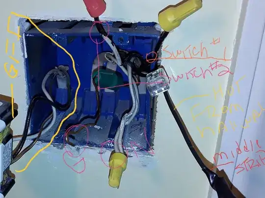

I believe I have two main panels that feed from one service line coming from the street. My assumption is they split the wire inside the wall with correctly sized wires to accomplish this (See older photo of opened panels).
I added a shop to my property and created a sub-panel on the right main. In my shop, I created a generator connection to feed power to my main(s) when the power goes out.
What I figured out last night when the power went out is that with the main breakers in the off position for both panels only the right main panel has power. I can not turn the mains to the on a position because this would cause power to go back up the service line potentially causing harm.
What I would like to know is, now in a power outage situation and with both main breakers off, how can I get power to the other (left) panel?
The left panel is the one I really need to be powered as it has our well pump and main light circuit on it.
Any safe suggestions? enter image description here
