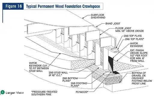

There should be no gap. Looks like shoddy construction.
See figure 16 from this page for proper alignment:
Also I have never seen a "band" or "rim" joist that are configured in the fashion described by your image. It can't be good that half of the wall is resting out in space.
You could rip a board to fit the gap so that the weight of the wall is transferred to the foundation evenly, but I would probably call a professional to see if that option is even structurally sound. I would not fill it with spray foam. Fix the structure first, then insulate.

    Another issue is unless the band or rim joist is pressure treated or redwood or otherwise resistant to decay, it will be very prone to rot where it sits on the concrete. If you can't determine adequate resistance, it should be replaced completely. – bcworkz Jan 26 '13 at 00:43
somebody did not know what the heck they were doing. the sill is meant to be wide enough and placed so as to be under both the joists and the "exterior board" or header. the header would then be the same width as the joists thus filling the space between the sill and the subfloor.
