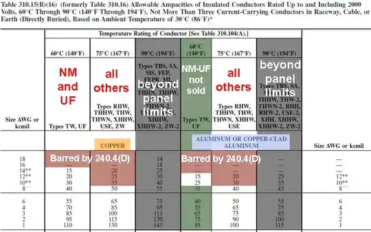

That sounds like defeatist language. In comments you say it is 3/4" EMT conduit and you have #4 in there for 60A. Let's have a look at 310.15(B)(16).
Since we're not using NM or UF, stay out of the 60C column.
There is no 60A wire, but #6 Cu is 65A (when it's not UF or NM). #4 Al is also 65A, but 3 of those won't fit in 3/4" conduit.
Three #6 Cu will fit inside 3/4" conduit with room for a bare #10 ground (if you even need that; it is EMT after all).
