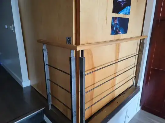

In my bedroom, I have a pair of wooden corner sliding doors, pictured below: corner doors
My cat is banned from entering the bedroom when we're sleeping here, since she keeps waking us up. However, actually implementing the ban is hard, because she learned how to open the doors. As a temporary measure, I'm tying together the handles (both of the doors have one inside), but I'm looking for a more permanent solution.

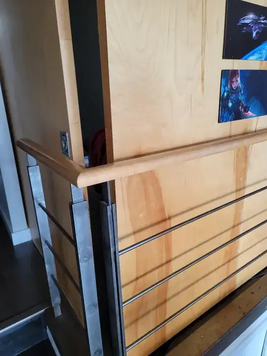

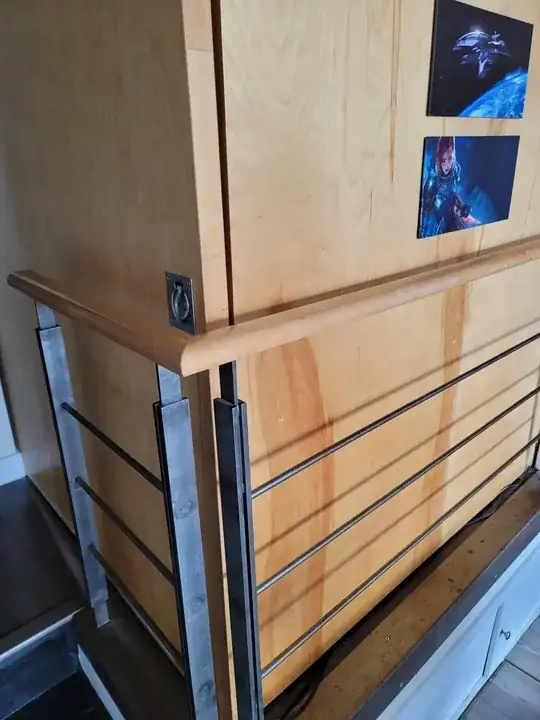

Adding more pictures per request. Closed: corner doors - closed The cat pushes on one of the doors, and here's the result: corner doors - cat broke in

    maybe it's just me, but i'm having a hard time envisioning how this works from the picture. Can you post a pic of what they doors look like when the cat opens them enough to get in? – dandavis Apr 03 '22 at 18:47
  • @dandavis Added more photos. – Noctiphobia Apr 03 '22 at 19:39

  • Do both of the wood panels move or just the one on the left, shown partially open in the last image? – FreeMan Apr 04 '22 at 15:05
  • Both can move. The cat opens the one that is not covered by the other one. – Noctiphobia Apr 06 '22 at 00:50

The doors appear to be meeting at the inside corners when closed, as shown in this crude ascii art:
 ___|_|
 ___|
Will one door go past the inside corner to fully cover the end of the other door, as in one of these:
 ___| |
 ___|_|
 ___|_|
 _____|
If so, you could use a standard pocket door latch that engages the door against the opposite jamb with a hook into a plate in the jamb. Use the covering door as the 'jamb' for the other door. Mount the 'jamb' hardware in the covering door, and the latch hardware in the covered door.
