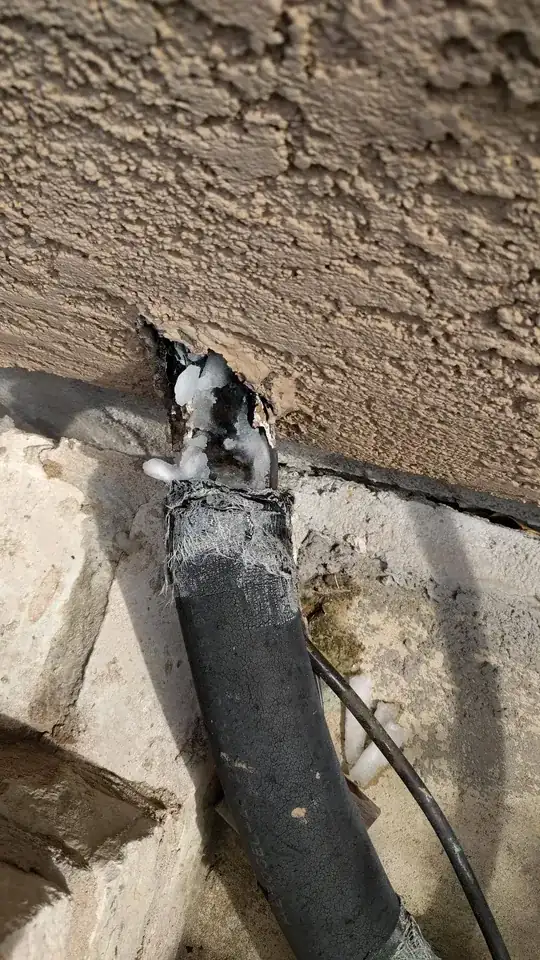

  • So I added the photo of the cable, if you can check and tell me if it can bend through walls it would be nice. – Johnnytest May 27 '22 at 11:17

  • The fiber which the isp brings is shown in the photo, @bobflux. It doesn't seem like it will bend much, so I'm not too sure it will make it through the conduit. – Johnnytest May 27 '22 at 11:14
  • It looks like normal outdoors fiber with the super tough jacket, same stuff we got here. It went through my conduits just fine. It won't do sharp corners, but then again you're never supposed to lay out conduit with sharp corners... Have you put in the conduit yet? – bobflux May 27 '22 at 12:48

The newly-added photo shows a specific type of fiber cable. The legend on the cable isn't entirely legible but it looks like it says 4F SMF, which means 4 strands of single-mode fiber, and doesn't actually tell us anything about the bend characteristics of the cable.
It appears to be flat drop cable which has typical construction like the photo below: (credit novalight.com)
flat drop cable cross section
This type of cable doesn't bend very well -- it's somewhat easy to break those fiberglass dielectric strength members. The Commscope flat drop product I've worked with can be wrestled down to maybe a 6 inch bend radius (a 12 inch diameter coil of slack in a hand hole in the ground is how I experience it). This cable would go through an ordinary bend in EMT conduit if helped along with a pull string but would break if forced into the tight bend of a conduit body. It also really only bends in one axis: up and down as viewed in this photo; trying to bend this cable "in-plane"
NEC 770.48(A) pertains to "unlisted conductive and nonconductive outside plant optical cables" entering buildings. There's a limit of 50 feet, which may be extended by "continuously enclosing the entrance optical fiber cables in rigid metal conduit or intermediate metal condeuit to the point of emergence." In a single family detached home you'd be unlikely to hit the 50 foot limit, however.
Interestingly, 770.48(B) indicates unlisted nonconductive outside plant cables are permitted to be installed in IMC, RMC, rigid PVC, and EMT conduit. "Nonconductive" means there's no tracer wire conductor, no metallic armor, etc. The one pictured is almost certainly nonconductive. I'm surprised that ENT "smurf tube" suggested by others isn't permitted for outside plant cable too, but there you have it.. I suppose one would comply with 770.48(B) while using ENT by terminating the OSP cable on the exterior of the building and transitioning to some other non-OSP cable to enter through the ENT conduit.
A drop cable like this is going to have to be terminated in some kind of demarcation box, at which point it'll be connected to a patch cable of some sort or a pigtail for immediate connection to the ONU/ONT right there in the demarc box.
The long and short of it is this: Install a conduit. The fiber provider may or may not be willing to bring their outside plant cable through your conduit into the building. If they're unwilling, at least they may place their demarc box near your conduit so that you can run copper or optical cable from there into the house.

  • u would not run fiber optic all throughout your new house... to future proof it for when terabit speed happens in year 3000. the toolkit to terminate fiber optic is expensive as well has no mainstream network and pc/laptop hardware support fiber optic connectors such as TC or LC, you'll then need media converters at each fiber optic wall jack so running fiber makes no sense.
  • run cat 6 or cat 7 copper throughout your house, connecting to a central location where you have a gigabit unmananaged switch that costs less than $100, so that each room has an rj45 wall jack. Cat 6/7 within the home will support up to 10 gbps keeping any given run less than 100m or 300', if you get a 10 GbE switch. Otherwise 1gbps is fantastic given internet service is at most 2gbps currently with frontier fiber and nobody really needs more than the 500 mbps plan; xfinity was hot sh1t @ 200mbps; and plan for where a wifi router will transmit as all tv's now stream via wifi they don't even offer a hard lan connection.
  • the fiber drop from utility pole only needs to enter the house and be run far enough within to locate an ONT, optical network terminal, which needs 120vac and converts the light stream to electrical; the ONT has 1 input the fiber ST or LC connector and 1 output an rj45 so you are then on cat 6/7 at best anyway. Partial context of your question... you do not run fiber optic all through the house and anyone suggesting so has no clue, the outdoor rated fiber from the pole enters the house and is run to where you want the ONT which could be just inside the exterior wall, or can be run to the deepest depths of the home doesn't really matter.
  • the outdoor rated fiber can enter the house and have a bridge... a disconnect connector, and then some other length of [indoor] rated riser/plenum fiber could be run however within the house to locate the ONT in some preferable place; it would only be one single run of jacketed fiber optic, kinda similar to NM 14/2 and UF-B.
  • for a new home just plan on having a nice hole pre made in the exterior wall or foundation so the tech can feed the fiber or coax or any cable into your house rather than haphazardly drill based on time of day and previous installation difficulty and aggravation.

Like posted above all of these answers are pretty dead on.
Running fiber to all locations in house would be top notch speed (which is super badass)...
However for MOST if not ALL of the devices you are looking to hook up to (wifi, tv, xbox, ps, computers etc..) RJ-45 connections are needed.
Like above $$$ you want to set up a household system for great fiber speeds. now that you have fiber at all the locations you want, now you need to use media converters that change from fiber to cat6. now this is just dumping even more money to bottleneck your speeds to devices that don't use the full potential anyways.
I wouldn't recommend wasting the money on fiber through the whole house just yet. The demand for that kind of speed to your devices isn't here yet.
I personally have Welink as an internet provider and I get about 600 up and 600 down; it's amazing. I have all my devices hardlined in with cat6 to an unmanaged 48 port gigabit switch (nothing fancy). I have 2 Google wifi devices (I do need an upgrade from these wifi 6 i.e. a faster connection which these don't provide).
I never have any down time or loading/waiting as long as I'm on the network streaming and downloading in the house is seamless. No need to spend big money for no reason.
Hope this helps.

  • How does your fiber come into the house? – Johnnytest Apr 06 '22 at 09:18
  • all the other answers are not dead on, they are clueless and is a perfect example why not to believe something on the internet because it has a bunch of upvotes – ron Apr 06 '22 at 18:19
    you say *I've been installing fiber infrastructure and devices for about 14 years now* butelaborate on your own *infrastructure* of *I have all my devices hardlined in with cat6*. :facepalm: so what fiber infrastructure do you have? – ron Apr 06 '22 at 18:24
